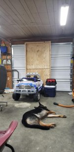

So, I do not have a ton of room in my a garage, but I’d love a lift to make routine maintenance and tinkering easier.
My two car garage is only about 20’x20’. The right bay is for my car (‘18 Camaro 1LE) and the left bay has my tool chest, work bench, bicycles, etc.
The right bay where the car is, is about 20’ deep, 10’ wide (to the pole), ceiling height is 9.5’, there is a beam at 8.5’ and the garage door opener is at 7.5’. There is storage above the garage that is another 3.5’ tall, which I’d love to eventually open the ceiling up to. But, for now I’m ok with the lower height with the option of punching higher later on. My main concern is the width of the area, what can I fit in this space???
A Mohawk A7 for my space seems like the holy grail, but I feel like I may need to settle for a quick jack or similar.
What do the garagejournal experts thing???

Mohawk and Quick Jacks are good. I have a friend who has a garage about your size and he has the Triumph 4 post lift in his garage it fits fine to raise his smaller pick up truck and his regular sized cars.

I have an Atlas 7K Kwikbay that lifts about 39" off the floor. It works well in my 8' high shop. It also makes a nice lift table to unload things onto, and an adjustable work table, and a motorcycle lift.

A mid-rise scissor lift could work in your garage but I suggest raising the garage door as high as you can. I’ve got a couple of friends who have quick jacks and I’ll say a jack and jack stands are better than a quick jack.

Do you need to be able to remove the lift for any reason, other hobbies etc...?
My garage is 20x30 and I'm kind of in the same situation since we have similar widths. I am looking at the triumph c-7000 because it's portable. I'd prefer an in-ground scissor like a lot of the guys here have done but the price is just too much for me to stomach. Atlas FM9SL is really ideal for me and my workspace requirements.
I am trying to keep a clear floor as I also like to woodwork and have other hobbies that the shop will need to accommodate.
EDIT; As we discuss this and I read the replies I am once again leaning toward the scissor setup.

If you buy a narrow 2 post, get one with angled columns so you can open the car doors. Or bias it a bit forward or back so you can daily park without the doors hitting the columns. I’d open up the ceiling to get the space if it would help, but I don’t understand how the beam could affect that.
You may be stuck with a max Jax or quick jack or scissor lift. Any lift is better than no lift. Scissors are my least favorite but some people like them.
I have a 4 post now, which takes away the problem of the doors hitting the posts. I bought a tall one so when it is up at 7 feet, I can walk under it. Again, I don’t know about the issues your beam would cause if you did open up the ceiling. I don’t think a 4 post makes any sense if you are limited to your current height.

Absolutely would not trade my 6500lb capacity scissor for anything else when ceiling height is a concern. In your space like in mine you will have to build some type of ramp system to be able to park the Camaro on top of the lift all the time....it truly isn't much of an issue once you get used to parking on top of it all the time.
The huge advantage in your situation by going scissor would be the lack of posts you would have to deal with on a 2 post set up..... with a scissor you can build the ramp system and park the car on top of it all the time and essentially take up zero space when not in use..... as narrow as your space is getting the width you would need with a 2 post is going to be a huge issue AND they will constantly be in your way.
