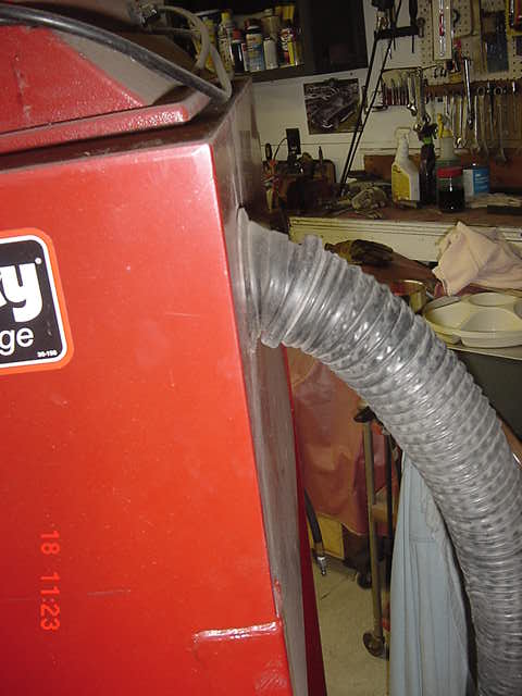

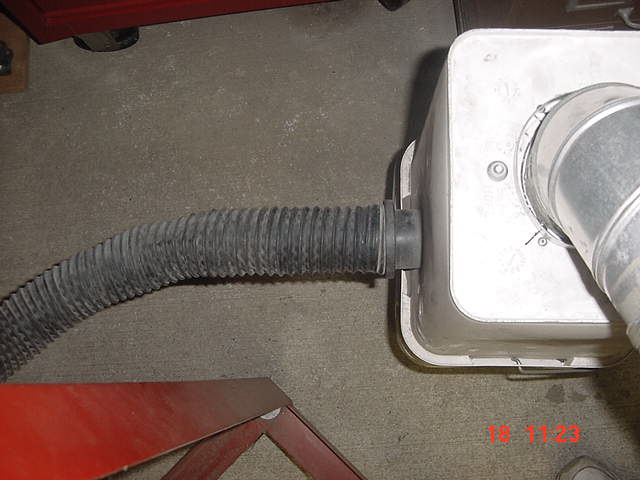

I built this cheap dust collector out of two kitty litter buckets and a shop vac filter. The motor is from Harbor Freight. I have about 130 dollars into it.... It works very well, I will use it without even thinking about it in the closed up shop during the winter...
Just saying, you don't have to spend big bucks. :)
A shop vac hose runs from the cabinet to the upper box.
I empty this out about twice a year, knock the dust off the filter and go back to work.
The really nice thing is, it all fits in the blast cabinet when it's not in use.
