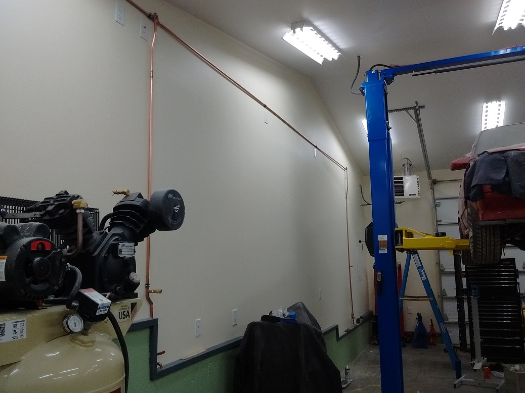

Started working on compressed air lines.
Copper is scuffed with a green scrubbie, and clear-coated.
The intent here is the compressor feeds the rail which is sloped to a drain leg, and all the drops come off the top so moisture is less likely to go down each leg, and each leg has a drain at the bottom.
I may not really know what I'm doing here - all I know is the air lines at work ****, and this makes sense to me.
I seem to have run out of elbows, so this is as far as I got today.

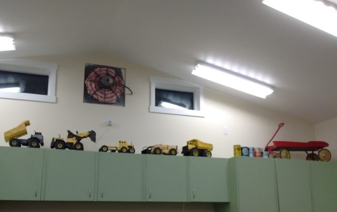

Toys on a shelf are not junk, at least not per my definition. That's reserved for project detritus that you trip over day after day...
Air line month! Which Is often followed by air dryer or air after cooler month! Haha...
Shop is looking good! Your pace is so much faster than mine... keep up the good work!

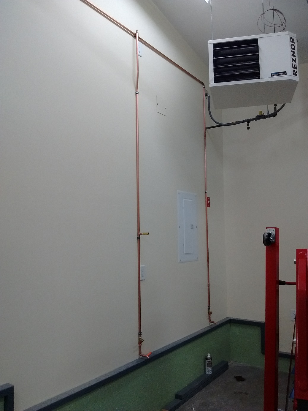

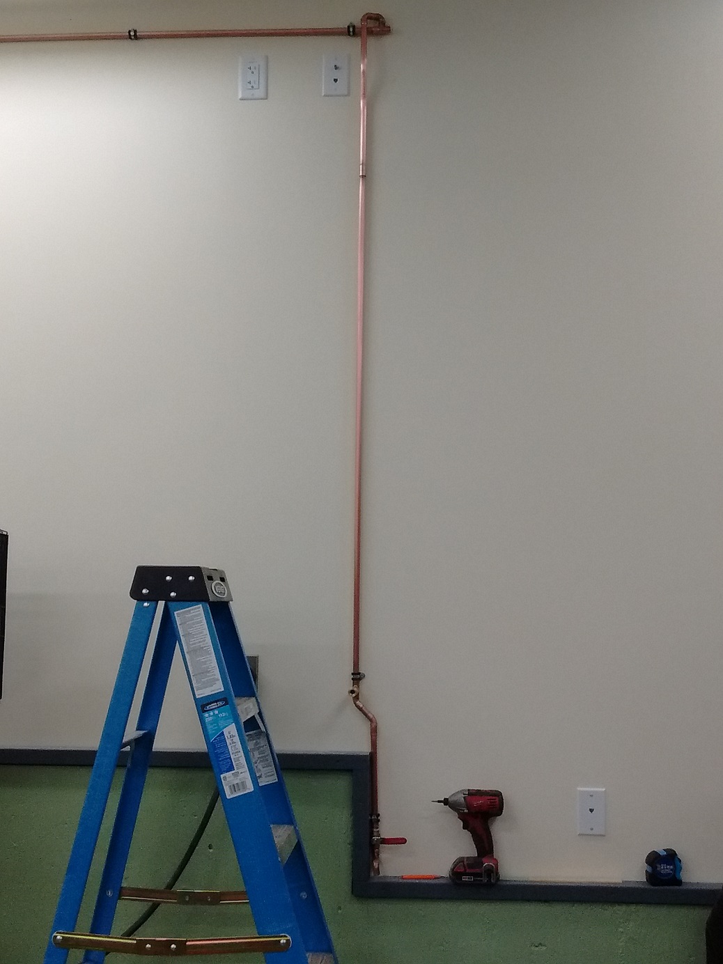

Added another leg to the compressed air lines.
Still not totally sold on the brushed and clear-coated copper, but I started and might as well finish. I can always paint it wall-colour later.
I really didn't plan the placement of this and the make-up air vent very well. Ugh.
Two more legs to run tomorrow.

And it doesn't leak - Yay! 100psi through the lines, and we're still in one piece. And there was much rejoicing!

It is always nice to have that happen, I'm still fighting a couple of old leaks, and one new leak in my shop air system. Well by fighting I mean they still leak and it is on "the list" to get to.

I was thinking of copper at the beginning but ended up going with the rapid air system and putting it in the wall all out of sight... Sure hop it doesn’t leak in the future...
My vote is stay with the clear coated copper...
Cheers Randy...
