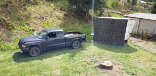

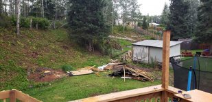

When we took possession we cut down a ton of trees including some very large ones. The stumps have since been ground up too. The shed came down with some help from my beater "trips to the garbage dump" truck
