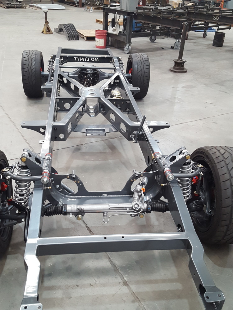

We have been working, started the plumbing.
needed some mounting brackets to hold a 3/16" brake line and a 3/8" fuel line. The aftermarket left me hanging so I fired up the mill and widdled out my own.
a dozen ought to do it.
R
Robert Haas
Sep 30, 2010
1,749
So we needed a fuel regulator as the pump I am using has way to much pressure for our carburetor fed big block. Holley has a nice unit so I went with that, I also bought the Summit 4 micron inline billet filter. with a little patience I got it all plumbed up.
:thumbup:

Killer build here. I've been silently following along. Regarding the front brake lines, why the hard line portion between the two flexible lines instead of one flexible line from the frame to the caliper?
R
Robert Haas
Sep 30, 2010
1,749
More about ease of maintenance and trying to keep it sanitary. I built a system a while back with full braided flex from chassis to caliper. I always thought it looked messy and I could never get happy with how I routed it.
The little hard line trick is something I did on an open wheel race car I worked on a few years back and I always wanted to do a street car with it. Maybe it will catch on and people will give me credit for it:D

Really great looking build, Robert. gets me fired up to go work on mine. I have a question for you. Did you mount the shocks upside down for any particular reason ? I have the same suspension set up and want to know if there is a secret I'm not aware of. Keep posting your progress.

I'll have to give Rob a call at No Limit, that is the way he shows them on his build using the same clip he sold me.

So I did call Rob' shop http://nolimit.net/ and spoke with Tina, and no, My shocks are not upside down. Ride Tech builds these specific coil overs for No Limit to be mounted "inverted" .

The shocks package better that way usually. It leaves the rebound adjuster on the bottom where it is easier to get at especially in the rear. You save a bit of unsprung weight.
It only works with monotubes though, you can not mount twin tube shocks upside down.
