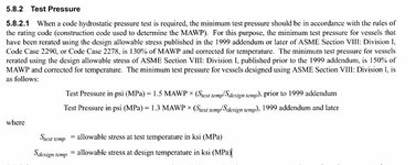

Is this Fact or Opinion?
If it has a ASME U stamp, that i haven't seen yet a picture of, it can be used for industrial/commercial use.
They require a professional to inspect the vessels every 5 years. At the plants I worked at it was always ultrasonic thickness inspections on the bottom for severe rusting reducing the thickness. Most of the U stamped receivers have been replaced long ago, plant started construction in 79. Some down stream with dryers for CMM rooms were still in use but they had little to no water in them.
There are pictures abound of a few tanks that have blown up, and a lot more that just start leaking out the bottom due to rust pin holes and are on the verge of blowing up.
Here is a good video of a home shop guy that had one compressor blow up and was proactive with his other one, a 1993, plus it shows several other explosions caught on CCTV
In a later video he sections this tank and you can see how thin the bottom is in places, 2:20 time stamp if you don't want to watch anything.
That was less than a min searching and 3 min scanning thru videos, there is a ton of more material just on youtube about it.

I do, without testing it. I know about catatstophic failures of air tanks but to categorically state that that tank is a bomb is just fear mongering.
That being said an old tank shoud be pressure tested.
I recently built my compressor with a used 60 gallon tank that I got from FB Marketplace, I did pressure test the vessel prior to building the compressor, the process I used is detailed in my post here: Garage Journal Compressor Build thread.
I ran a 12 hour hydrostatic pressure test at 3 time the rated pressure that the tank would be pressurized to. It's easy if you have a pressure washer and garden hose.
To use a 50 year old compressor tank without prior testing is dangerous. But age is not a death sentence if the tank is regularly maintained.
To use a used air compressor tank without pressure testing it prior is reckless and dangerous, but your categorical assumption that it's inherently dangerous is reckless.
Why? Its done as part of the manufacture to test the welds and heat affected zones . The pressure inspection code or API 510 states
API pressure vessel inspection code
page 25
I have never seen a pressure test done on any of the hundreds of U stamp ASME pressure vessel inspections i have done personally or been part of. But every inspection has used methods to measure metal thickness and compare to the data tags specs.
Why did you choose such a high and unsafe pressure of 3 times the working pressure? Its supposed to be 1.3-1.5 times the max working pressure. It is likely you deformed/stretched the metal at that high of pressure?
ASME UG 99 hydro test is the initial test and if alterations or repairs have been done, API 510 says the exact same thing.
source is same API 510 document above.
I am basing in on hundreds of inspections the I perform routinely for my job on ASME pressure vessels. I have never seen an air receiver directly after the pump anywhere close to that age pass, even with auto drains. If the pits exceeds the corrosion allowance specs from the supplier the tank is scrapped. Reckless is the opposite of what i have been accused of with regards to safety.

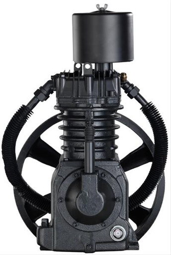

A Campbell Hausfeld TF series is an industrial quality compressor pump.
I had taken photos of the whole unit but they didn't save for some reason.
It doesn't look Homes Depot quality to me but shop quality at least.

As far as your compressor goes, a good industrial grade pump is going to be better than just about anything you can pick up at an actual store these days so even if you have to get a different tank for it it would still probably be a good deal as long as it is in working order.
Not sure if this is the exact one, but I got a similar one on a tank I got for my compressor build. It was apparently a Champion design originally (mine is labelled SpeedAir). Parts are readily available.
Also this was the spec plate said on mine with a 7.5 HP motor:
23.5 CFM at 175 psi
23.5 CFM at 175 psi
Silimilar.
Says Campbell Hausfeld a Scott Fetzer company. Whoever that is.
