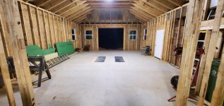

Its still in progess. Poured the lift pits off the atlas flush mount plans.
Got a long way to go but its dried in now. But I like the fact that the lift will completely dissappear. I dont only do auto work so having a 2 post always in the way just wasn't going to work for how I use the garage.

So I built a 24W 32 Deep 10'Wall pole barn 3 years ago and put a lift in this past december. It's awesome! I went with a split 12' sliding door and lift centered on the 24 gable end. I've got a kubota tractor that I can park between the posts and wall no problem....its about 5 feet wide.
