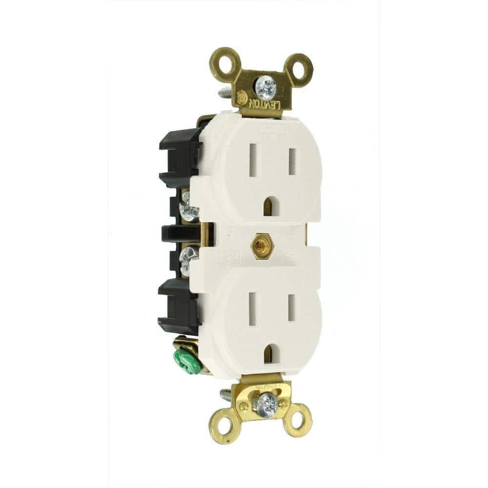

ummm spec grade has never been the cheap bulk ones.... spec grade is a step up from the cheapo ones.
ummm youre mixing up the push-wire terminal on the back of the receptacle with the retention strength of the tangs in the front of the receptacle. 2 different things on a receptacle. not sure why youre comparing them...
BTW the push-wire terminals ARE dangerous. they cause fires due to that spring loosening up....
I'm not sure how you got either of those interpretations from my posts, so let's try again.
30+ years ago, bulk outlets were dangerous ****. They had brittle face plates that could fall off and terminal screws with a flat surface under the head that pushed wires out, among many other fatal flaws. I'd seen way too many outlets exposing their live guts when a face plate ripped off or snapped after someone carelessly pulled out a plug by tugging on a cord.
The spec grade outlets I was buying at the time (30 or more years ago) had unbreakable face plates that were permanently riveted onto a solid steel backstrap that connected to an embedded nut which better grounded the plate cover, and they had screws with vaulted square washers that did an excellent job of securing straight in wires.
Today, even the cheapest of outlets have terminal screws with a cupped profile under the head that pulls your wire in securely, and they all have unbreakable faceplates that are generally welded on ultrasonically.
What better outlets still lack are better plug terminals parts. I'm NOT talking about back-stabbing, which I'll leave to the PVC air line people. I'm talking about cheaping out on brass. Cheap outlets have fingers stamped straight off the bus, which puts all the flexing on one small part of the brass. They fatigue easily. Better outlets have their brass stamped into a U or other elongated and curved shapes that spreads the flexing out over a wide area as a spring should be. These will stand up to many times more insertions that the cheap ones. Break apart a hospital grade outlet for example and look inside (not that hospital grade has that as part of it's spec...).
No way!! Sorry operator error.......Loop the wires so they are CW under each screw - the wire will wrap under the screw head as you tighten. Use a #1 Robertson or #1 Combo tip. You will be surprised how much tighter connections are than with phillips or flat head.
Actually becomes a PIA to remove wires!
Look into Klein# 665 or 7314 or equals.
I've had Robertsons strip, and my Leviton stuff doesn't even accept Robertson. Right now, I use a Milwaukee ACX screwdriver for brands that have the square center, and a Wera PlusMinus Philips for the other type. But I do agree that neither Phillips nor slotted do a good job on brass screws.
I believe that the push in style where the screw tightens against the wire is better than wrapping the wire around the screw. But, what do I know. I can't even tighten a screw properly.
Most GFCI's I've worked with have wire clamps. They're excellent, easy to use, hard to mess up, and can make it easier to have lots of wires in one box, BUT "better", well, both styles work just fine.
umm that is NOT a "quick-wire" push-in terminal. No screw is used on the "quick-wire" terminals. youre mixing things up again.
a wrapped screw will always be better than a "quick-wire" terminal.

yes that is called back-wire which is NOT the same thing as "quick-wire push-in" terminals, which is what they were describing. Leviton receptacles that have the clamping plate are labeled as "industrial grade heavy duty." these are very expensive. they have a clamping plate inside the receptacle that moves up as the screw is tightened. These receptacles also have "side-wire" option which is where you wrap the wire around the screw.
Then theres the spec-grade style back-wire connection receptacle. Leviton labels these as "commercial grade". theres a plate just under the screw head outside of the receptacle. you insert the wire under this plate. the wire is clamped down towards the receptacle as you tighten the screw forcing the wire against the receptacle.
But neither of these are what @428PI was describing, which is the cheapo "quick-wire push-in" style receptacles. leviton labels these as residential grade. they cost less than a buck. you can also do side-wiring on these by wrapping the wire around the screw...

Wrong. Those were what I was describing. (maybe you were thinking of my surface mount plug). I was talking about these Leviton 15 amp commercial ones. Just installed 2 of them. I didn't wrap the wires but did shove the wires under the plates under the screwheads. I actually put 2 wires under one plate (not sure that's kosher but thought that that was better than cockeying the plate with just one wire when running to another receptacle). I like that much much better than wrapping the screw.
they were? couldnt be. you called them "push-in". the spec grade commercial receptacles do NOT have push-in terminals. your quote is below... maybe youre confused on the terminology.... also, unless youre wrapping the wire around the screw, the screw wont be tightening around the wire.... only the plate tightens on the wire.
