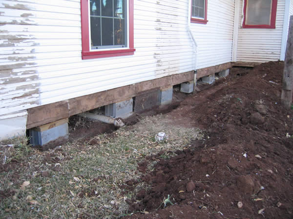

I was going to ask - if you guy pay real estate taxes, does your building escape the appraiser because it's a "portable". Our portable buildings here don't show up on the tax man's radar.
Question for you - I'm designing a 10x16 shed and would love to do something like that to make it looks 'at grade' rather than up on piers. I'm assuming that enough air gets in between gaps to keep it ventilated underneath, but also small enough holes that you don't get critters setting up a resort under there....?
I can comment a little to that -
Our old house was a pier and beam but it was set so low to the ground that only skinny plumbers could get under it. In fact, when we leveled the back bedroom we had to take the floor out to do it. On all sides, the band joist was right at ground level. The house was skirted with steel siding on all sides to keep critters and water out. The only penetration was the drain from the AC unit. There was no venting. To get under the kitchen side to fix the front bathroom drain required a wide ditch 18" or so deep to remove the skirting and tunnel under the house. The house has been there like that for 60 years. So - it CAN be done. If I were to do something like that, I would put a good vapor barrier under the building and use galvanized skirting down at least 18"~24" on all sides.
