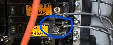

Free energy for all ? The op have this problem that he probe voltage at breaker is different from voltage probed (higher) at the end of a 70’ electrical run ? So rms is the answer?
Nah, OP is using a crappy meter that is most likely out of wack on top of being crappy and everyone is out there running crazy trying to solve the problem by using differential equations. or something.
It’s been point out multiple times. Op have a crappy meter, but as long as he took the measurements correctly on the same setting and time frame, the voltage differential should not increase and should only be decrease under normal circumstances at the end of a 70’ run. Vs doesn’t change right ? Why would Vpp be higher at the end of a 70’ run and not at closer to the Vs? Right ? Breaker is Vs. let’s say it’s a crappy meter but still a meter that behave the same for point a and point b measurements right.
Pretty sure this is the wire condition when op took the measurements, doesn’t look like there is a load on the end of those wires, doesn’t looks like it’s in any flex conduit or it is pulled into a conduit yet. (Maybe, dunno for sure) but this pic. From his other thread says, it ain’t looking liking it.
