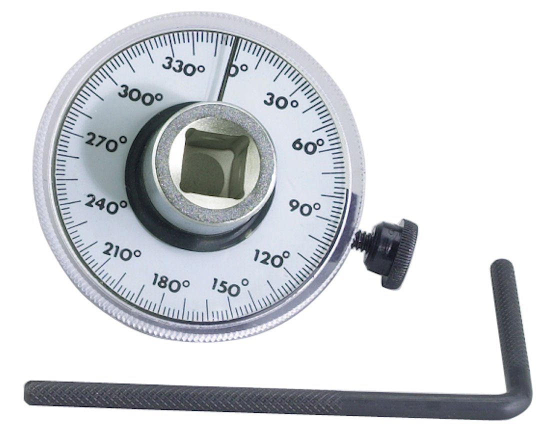

Hi everyone: I bought a Gearwrench digital torque wrench with a built in angle meter for a head gasket job. The manual says torque the head bolts in 3 steps: First, torque them to 25 foot pounds. Second- turn them 90 degrees. Third, turn them another 90 degrees. The manual says lube the bolts threads and under the bolt heads with oil. When I broke the head bolts loose on the head, I used a 1/2 inch drive 24 in long breaker bar, these head bolts were on really tight. Now, my question is: Can this torque wrench handle the job without the gear head breaking on me for this high torque requirement. I bought this digital wrench thinking that with a built in angle meter it would be easier to do the job without resetting the angle and finding a different spot for attaching the dial angle meter for every bolt.
This torque wrench can torque up to 100 foot pounds.
The manual says to mark the head bolts with a paint mark in the front after the first 25 foot pounds and with the 2 additional 90 degrees, the paint mark will be in the back at finish. Is it a better way to do this job without spending extra money for a dial angle meter?
I'd like to hear what you guys say. Thanks.

torque it to 25 foot pounds and then use the breaker bar to do the degrees.

You will never get to final angle without overloading the torque wrench. Once you do that it will go into an error mode and you will need to send it to Gearwrench's repair facility in Dallas, TX. (see your owner's manual).
This is a big problem. The initial torque is well within the capability of the wrench but the final torque after the angle adjustment is beyond it's max torque capacity. Reply to me if you would like more information.
You will easily be able to do the first 90 degrees. As a matter of fact the tool will display the final torque value reached during the degrees part of the program. It's display will alternate between angle and torque value. But, you're going to run out of range on the second 90.
FRANZDOM: That is completely wrong. Once you go over 110% the wrench will go into error mode. Elcatorq, the brand I sell and is relabeled and also sold by MAC, is fanatical about this. If you overtorque the wrench it will display ERR-0 when you turn it on. This can only be turned off with a special software program (which I have).

After you get them to the relatively low setting of 25, you are done with the torque wrench. I think my 1/4 inch torque wrench almost goes that high. Use a breaker, ratchet, T-slider, whatever. Start with it pointing forward and swing to pointing sideways, rinse, repeat. There must be some direction you can swing something 90 degrees at each bolt.

mark corner of bolt that's pointing right, go till your mark is down, rinse and repeat

I bought this 3/8 digital torque wrench with angle for the reason of not having to setting up a dial type angle meter. However, I underestimated the angle turns would put such a high load on the torque wrench for this job.
scarney1988
May 13, 2013
508
Time to purchase a 1/2" with angle feature or just mark everything and use a mirror and a light. I do not think marking it and going that route would be that difficult IMO. Also you could remove axles and cherry pick the engine+trans unit and do it out of the car.
EDIT: Just reread your posts and noticed you already have the head bolts off/loose. With that I would say
-paint marker + breaker bar
-Angle adapter
-1/2" torque wrench with angle feature

may be an angle adapter or another torque wrench.
I meant to say an angle adapter, not another torque wrench.
I can do the hand torquing with not much difficulty, but for the right cylinder head which is by the firewall, is a little bit harder, and these are 12 point TTY head bolts. I have to use an extension to reach down to these head bolts and turn the breaker bar with an eye on the angle gauge.

torque with wrench, then pull out a breaker bar to stretch the bolts. you can use a sharpie marker. just draw a line. if you cant see the line has moved from 12 oclock to 3 oclock you shouldnt be doing the job. dont over complicate it.

The benefit of having an angle gauge on the breaker bar you know you are approaching the desired angle, you don't have to guesstimate how much an angle you have turned. A white dot on the head bolt at twelve o'clock before the angle rotation would work.

Tighten to 25ftlbs, mark the bolt for starting reference, head for 90 and 180. Place socket/breaker bar on at 0, then place it where 90 would finish so you have an idea of where to stop and check.
