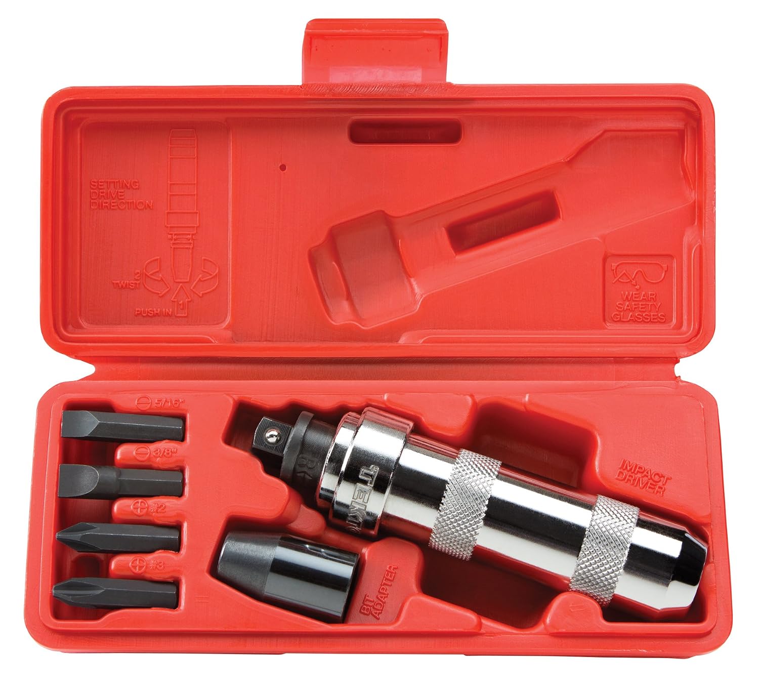

Any reason you can't use one of these? They can always be used like ordinary screwdrivers.
O
39,649
I have several of those, but it's not what I want to carry in the rig all the time... (For the much larger "road box" that is not a problem)

Cut a long one and weld it up any length you want. Personally a screwdriver is the devil on a sammy. I use hand impact driver or my dewalt impact to bust loose. 30 years of road grime and mud, I've stripped a few. Usually end up grinding a flat in the head hen using impact driver with flat bit lol. Those samurais sure are fun
