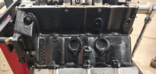

I run a Buick Motorsport (BMS) Stage 2 on-center block. The factory "109" block that the GN came with simply wont live at the power level I am making with this motor which was over 1400hp in 2009 and I am planning on 1600 with the new set up.
A little background on all the different Buick blocks which can be confusing. Buick had a very successful race program through the 80's and well into 90s. The Grand National itself was made as a testament to the success of the Buick V6 in the NASCAR Busch Grand National series which it dominated for a long time. In addition they ran successfully in Indy Cart, ASA and Indy Lights programs among other programs.
As result Buick made a ton of high performance parts, 4 bolt main high nickel content blocks with 14 head bolts, forged crankshafts and host of other cool stuff. They also made a symmetrical port Stage 2 cylinder head which is really bad *** and almost all the really fast Buick guys run, except me of course lol!
The Buick V6 originally was an odd fire motor where two rods shared a common crank pin and the Odd cyl fired at 90 degrees and the evens at 150 degrees. Needless to say this wasnt the smoothest motor so Buick made it an even fire by splitting the common rod journal on the crank and firing even and odd cylinders evenly at every 120 degrees. When they split the rod journal it added an 1/8" of material between the rods so Buick off set the rod to the crank pin instead of designing a new block. Most all production Buick V6s are off center motors including the one in the Grand National. The original Stage 1 and 2 blocks made by BMS were also off-center but they eventually went to on-center. The on-center blocks are a stronger block with less side load and wear on pistons and bearings but the odd bank of cylinders is now an 1/8" off from a production block. While factory heads will bolt right up the factory intake will not since it is now an 1/8" off. Everything else will still work with some tweaking and spacing and it is no longer just a simple bolt in for a stockish Turbo Buick. Most on-center blocks are also dry sump with no wet sump pick up provisions so they require an external oil pump or one of the "Duttwieler" pumps that uses a factory front cover and pump housing.
The early off-center Stage blocks are highly desirable to the Turbo Buick guys since they also have wet sump provisions and can easily be dropped in a Grand National with all the stock parts bolting back on the motor including the intake and accessories. The original motor in my Ttype was a girdled 109 block with stroker crank. I ended up with an offcenter S2 block that I built for the car.
Here is a pick of a Girdled 109 block which I had in my Ttype originally.
I sold this motor and built a 3.8 012 off-center Stage 2 block for the Ttype which when installed looked identical to the motor that was in the car. While the Ttype is a legit 800hp motor it was within the capable limits of the 109 block pictured above but S2 can handle significantly more power. The biggest difference is the steel four bolt mains and 14 head bolts as opposed to 8 for the factory 109 block. Here are pics of my Ttype S2 short block notice were the wet sump pick up is compared to the 109 above.
Like I mentioned the on-center blocks were stronger and BMS made a bunch of them the early ones were like the off centers and actually had wet sump provisions a place for an oil dip stick, then they started cross bolting the front and main rear caps and were totally a dry sump block with no dip stick provisions.
Here is a pic of a S2 oncenter with x-bolted front and rear main caps. This is actually the short block I ran in 2009. It also had roller cam bearings in it which is what the oil line in the valley was for.
Now the short block I am going to run has 6 bolt center caps. The crank is a new 3.625 billet Crower, rods are 6.300 Crower billet, the pistons are 4.025" Race Tech with about 10.5:1 CR at about 278ci. And yes I will run 40 psi of boost with that CR lol!

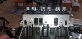

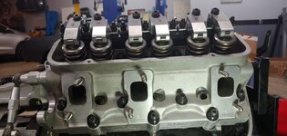

So I covered the bottom end and now for the top end. One of the things that makes my engine combo unique or at least different than the other high HP Buick V6's are the cylinder heads. I am running a Stage 1 production style wedge head that is essentially the same head configuration that came on a production. Almost all the high HP (over 1200) combo's are running the Buick Motorsport Stage 2 heads which were never used on any production motor but used extensively almost exclusively in Buick racing, and for good reason it is a bad *** head! Not only that but they are plentiful and relatively cheap compared to running an aftermarket production style head.
Below are pics of a Stage 2 motor and heads that I picked up as a back up and was actually a Childress Racing motor. As you can see S2 heads are radically different than a production style head.
The factory head is a "8445" casting and they only came with 8 head bolts so they are not very useful on a block that has 14 head bolts. Buick did make a 14 bolt cast iron Stage 1 head but they were experimental and only a few sets were produced. I have only seen one pair of them ever. Buick did make a Stage 1 8 bolt iron head which I actually had on a motor back in the 90s. Below are a set of 8445 heads that had extensive amount of work done to them including moving the valves for larger springs and overized intake and exhaust valves and used a custom set of shaft mount T&D's. They were on the 109 motor I had in my Ttype.
The first aftermarket head for the Buick V6 was from M&A castings and was almost a direct copy the BMS Stage 1X head with 14 head bolts. These heads flowed well for the times but had a lot of porosity problems with the castings. Champion Racing released a new aluminum head in the late 90s for the Buick V6 with 14 head bolts and custom T&D's which I have a set of on my Ttype.
The Champion heads worked well but developed cracking problems on higher horsepower cars. I went through at least 3 sets of them between 2005-2010 and the last set I had on the car in 2009 was literally held together with GM Seal tabs lol. Tom at Champion continued to improve the head as we pushed the limits and eventually came out with a more durable casting which he made with a custom raised runner for me in 2010. Unfortunately I never ran the car with this head, I did however flow them against my current head and a set of Stage 2 heads for comparison.
Unfortunately Tom at Champion passed away a few years ago, he was an wizard with cylinder heads too and a real loss to the hot rod community. Champion Racing Heads was recently purchased by another Buick owner who is currently trying to breath new life into the business.
Finally for the heads I am running are from TA Performance who released their own casting around 2008. They are a much beefier casting and to date the only TurboBuick to make over 1200hp with a set of Stage 1 prod heads and not crack them is my buddy Tommy who ran TA heads when he went 7.80's@176. I think I posted the video of that run earlier in this thread. The TA heads I have flow about 20 CFM more than the raised runner Champion above, have a much better pushrod geometry and literally wiegh at least 5# more than the Champion head. If I crack these heads I will be going to the Stage 2 head. The TA's flow 290 on intake, the Champions 270 and the Stage 2 335 all on the same bench same day. I seem to have pictures of everything except my cylinder heads lol!

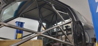

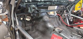

Well it has been a long last two weekends so I am going to skip over some of the motor build I did previously. Ray and I worked on this Fri-Sun last weekend and this weekend and easily have 150 man hours in it between the two of us. But the cage is DONE and has passed NHRA inspection for a 25.3 cert for 6.50 ETs and slower and up to 3600#!!
I am actually exhausted but can't even begin to tell you how proud I am of the sticker. If you have been following along we had no idea how to tig weld, bend tubing or any of it before we tackled this project and really learned how to do most of this by watching youtube!

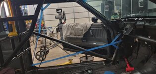

Once I got the new headliner installed and top of the cage painted I dropped the body back down for the last time, or so I thought...
We got the primary diagonal door bars bent and in and I started laying out the secondary bars and the gussets need for the 6.50 cert.
Once I started on the secondary we quickly realized we didn't account for how to weld the outside of the bar. We put a lot of thought into how go about building this and still being able weld it but didn't consider this part. It looks nice having the bars all tucked nice and tight to the body but you still have to TIG weld them 360 degrees which is literally a nightmare.
image20081.jpgWell you have to be really creative and we got lucky with this one as we were able to raise the body to get the out side of the weld in hole that the factory runs the door wiring harness through. Ray some how got two hands and a tig torch in there and was able to weld the outside of the bars.
Once we passed that we dropped the body down for again the time and finished the rest.

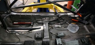

We finished up the last pieces of the cage this past weekend by welding in a x-brace and the rear clip bars. I only have two gussets I need to put on the parachute stub that are already made and a couple of small spots to weld. That is it no more bars to bend fab or weld at this point. The last few things to tackle will be the pedal mounts, window net and tabs for seat belts, fire system and parachute cable etc.
I had a hard time deciding if I wanted to put a mini-tub in along with another crossmember in the rear but decided against it. The frame rail notch on the car is not really deep and can be cut another inch or so back to the inner rail which is all that is required for most classes. This would need to be done in order to any more clearance and make putting a mini tub in worth it. If I cut the frame rail any deeper I would also be required to run another inner frame rail since my current frame is actually a boxed steel frame rail it is accepted as a part of the 25.3 spec without the additional 2b inner frame rail.
That extra rail would also create a lot of extra cutting. So we decided to stop here. I accomplished what I wanted and that was getting a 6.50 cert and keeping as much of the original car as possible. This car still has the most of the original floor and trunk pans, stock wheel tubs, all steel and glass body and will have most of the factory interior including back seat. I am hoping the current motor will run down into the 7.50 range so it didn't make sense to me to do a 7.50 cert cage that really couldn't be upgraded down the road to a faster cert without almost completely cutting it our and starting over. Right now if I decide on a faster combo or something stupid like twin 98s on methanol on a BBB with billet heads the rest of the car can be updated pretty easily.

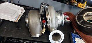

The turbo is a mid-frame NLX88 from Bullseye and it is a pretty bad *** piece. It is 88mm compressor billet comp wheel they are are known for making big power in addition to looking cool.
This one is rated at 1850hp, I am hoping to get 1600 out of this combo.
Bullseye makes all parts for this turbo including a billet center section that is dual ball bearing and a custom compressor cover with a tunable compressor cover that allows you to adjust the inlet
The turbine side is where most of the big changes are happening. My old combo had a journal bearing billet wheel Precision 4788 with a T4 flange with a .96AR housing with a 92x82mm Garrett turbine wheel. The NLX88 has a 96x88mm turbine wheel with a 1.00 AR housing a 3" V band inlet.
I considered going straight to a T6 housing and turbine flange and at the power level I am planning it wouldn't be a bad choice especially if I decide to go bigger as just about every turbo bigger than this will be on a T6. After talking to Bullseye they told me to save my money and I should be able to get the power out of this combo with their turbo that I am looking for.

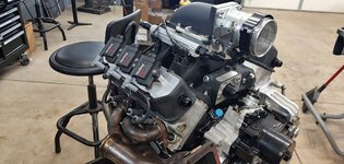

It has been one year today that we pulled the car apart and started this project. It is still not done but we keep plugging away at it and today actually put the body panels back on and the car looks like a car again.

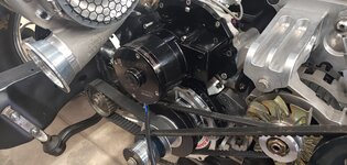

Once we got back from Orlando and watching the start of Sick Week I put the motor and trans in the car to start fabbing the cold side. We also had to figure out the pedals and steering and start gettin. Since I am only 5'7" and I moved the seat back I was worried about the pedals. We were able to simply make spacers for the factory pedal bracket and bracket pedal bracket that worked out perfectly. We also cut and fit the steering shaft and u-joints.
We then started on the header. We made a bracket to mount the turbo and cut the old flange and cross over pipe merge to make a new one.
So far it turned out pretty nice. I still have to build a downpipe and wastegate discharge. I am going to get them coated too and looking at a product from Zycoat that is supposed to work well and hold up on turbo headers. It is expensive though.

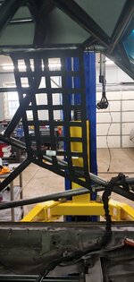

We also had to come up with a window net. I bought a kit with buckles from ART that just wasn't going to work. After doing some more research I came up with one from Tim McAmis that is probably the nicest well thought out window net kit out there and has a quick release spring that makes releasing it really fast and easy which would make it safer if you have to make a quick exit.

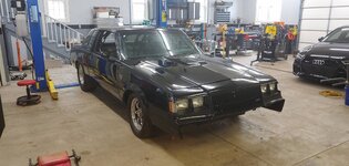

We then decided to put the body panels back on. We need the front clip back on the car to do the cold side pipes and also to make the front clip bars which I am still considering how or if I am going to run them. It is cool to see it look like a car again.
I have the dash mostly fit but still have some work to do there too.
It is starting to come together and I feel it is coming out really nice. I am starting to get really excited about this thing running again some day soon. We are going to finish up patching the floor and trunk pans tomorrow then seam sealer, cage paint and then some final assembly. I still have a few tabs to mount such as the fire bottle cable and a couple for the dash.

The headers. We spent a ton of time redoing the passenger side header and crossover for the new turbo. We made a support bracket with a Maven mount not once not twice but three times and finally got it all to fit and look really good, or so we thought! We forgot to check the clearance for the water pump out let which with the Meziere pump is a -16an fitting out of the side that is in a slightly different location than the stock water pump.
Fortunately I think it is going to be an easy fix where we just weld a new exhaust flange on top of the old flange and then make a new 4th support bracket. The new flange will move the turbo up about 1/2" and should provide enough clearance for the water pump. At least we didn't fab a downpipe yet that would have been even more of a mess. I am waiting on a new radiator from Champion which is a dual pass core that is made for a LS motor swap in a G-body. My original radiator worked really well but was large single core race radiator and I was worried about cooling on long drives and freeways which we will be doing with DnD events. I should have it by the end of the week and once it is here I plan to plumb the entire cooling system and make sure EVERYthing fits this time!
Third set back!
This is the one that really was a punch in the gut and was just sloppy work on our part. We got in a hurry trying to get the cage close enough to finished when the chassis inspector was on his way and ended up welding the upper secondary door diagonal on the drivers side welded in to high and it is in the way of the door handle. I should have known and stopped and fixed it earlier as the x-brace looked like **** too and it was our first attempt at an x-brace. Anyway the bar is a difficult one to weld and also has two gussets welded to it but and I've decided we are going to cut it out and make it right. I can move the door handle to make it work but I will also look at it everything I go to get in the car and it will drive me nuts.
This is how it was supposed to fit
The last issue isn't really a set back as much just a change of plans. It is how we ran the inner frame rails and rear floor pans. I dont like how they are going to turn out and decided to section them raise them up and weld them to the cage itself. This is actually preferred for safety reason on a car with a separate body and frame and what I originally intended to do. This will also give us more clearance underneath and we may be able to build a 4" over the axle exhaust system which would be really cool to do but not sure about getting it over the axle as I have a lot going on back there.
If I were doing this project again from the start I would have cut the entire floor pan out from the back of the drivers seat to the rear tailight panel in the trunk and replaced it with sheet metal and carbon fiber wheel tubs. It would have taken at least 150# off the car and made this whole process WAY easier than it was. But no I needed to keep the back seat and wanted to retain as much of the factory car as possible lol!
My next post will show some progress and some stuff finally coming to completion.

We started with fixing the header and turbo location so we can finish the hot and cold side along with putting the motor together. In sticking with the theme of this build we kept all the parts in the stock location, turbo, crossover and down-pipe with really isn't easy when the tubes are larger than factory stuff. I had the headers custom made for the car back in 2008 and at the time we thought they were really nice until we actually started to learn how to do this stuff and found out they really aren't that nice. We made them work but at some point if I keep this combo I think we will build a new set. Same with the IC, the largest pipes we can get under the factory core support is 3" and even still I have killed a couple sets and had to re-weld new elbows on once due to smashing them on wheelies. We made a 3" extension off the IC to a 4" inlet pipe with a clam shell clamps on everything.
To fix the turbo location we just extended the mounting flange and instead of cutting the old one off we left it as it would have been a PIA to take off and butted up against the WG tube gusset. It turned out nice but took some finagling and tweaking to get the turbo to sit level.
We got the WG discharge mounted and the lower radiator hose fit nice once we got the turbo in a better location. I am going to heat wrap the WG discharge pipe. There is more clearance than it looks in the pic.
