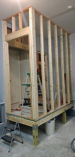

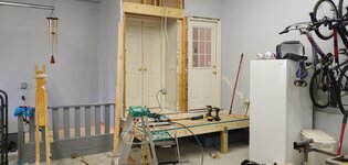

I have been up to my eyeballs in a promised house remodel since Oct of last year and living in my basement since Nov 16th when I tore out my kitchen. I literally just got the water running in the new kitchen this Sunday and we are starting to slowly move back upstairs.
I got the new garage/shop in 2018/19 and the wife is now getting her new kitchen staircase flooring fireplace etc. We began planning in Aug of 2020 after a plumbing issue left a huge hole in our family room ceiling which we stared at for over a year. After ordering all the cabinets and countertops and flooring at the end of September my buddy who was doing the work put me off again on starting for another 6 weeks. So I decided to tackle it myself and did some framing a lot of demo and even tore out the main support wall in the house and put in a new laminated beam to open up the dining room for a more open concept.
While I am well versed in engine building and hot rods not so much wood and drywall! Nothing is straight with wood and my OCD can't stand it! I tore out a coat closet to build a new closet/entrance to the house and it was my first framing job and I had to rip it apart at least 3 times. Fortunately by the time I was ready to tear out the main support wall in the house. I demoed the pantry which used to be across from the entrance from the garage which was completely stupid along with the rest of the layout. My Buddy did show up at the beginning of December and by then I had all the electrical and drywall done too and he was able to start on the finish work which I do not trust myself to do.
I will post some before and after pics when its done we are just finishing it up now.

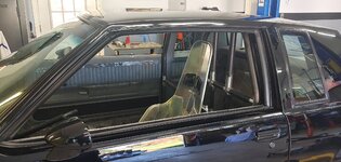

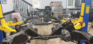

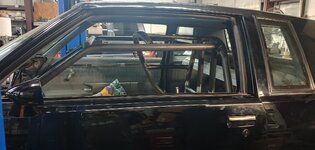

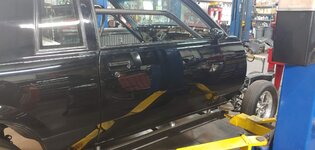

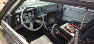

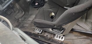

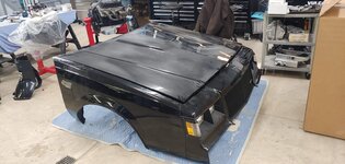

I have been struggling with what to do with the GN ever since I got it back and most of it is the same issues I had back in 2010 when I sold it. I've been saying its kinda like dating an old girlfriend it cool and exciting at first then you start to remember all the reasons you broke up with her in the first place lol!
The car was in need of a serious update in 2010. To go forward and actually push the car into the 7s it really needed more suspension and an updated chassis cert. updated wiring and ECU list goes on. Updating the chassis and going from a standard 8 or 10 point 8.50 cage to a 7.50 cage with floor bars and a funny car cage for the driver is a pretty extensive modification that requires a lot more cutting and modifying of the car. On top of that the difference between a 25.3 6.50 chassis cert and a 25.5 7.50 cert is minimal just a few more bars and a few that are a larger diameter so the decision was made to build a new car completely from scratch with a 25.3 cert and sell the current one.
Well life happened and struggles with the chassis shop then the body shop and by 2016 I was done with the with the project and bailed on it entirely. At this point I was pretty much got out of hot rods and racing althogther and focused on triathlon completing a full ironman in 2015. After I sold the 25.3 spec drag radial project is when I got my T-type back which eventually lead to the garage build which brought me here and has now come full circle with buying back the GN!
When I sold the car it had a completely new motor built for it. In 2008 I had a bunch of problems with Diamond pistons and them not building a piston with enough material in the top ring land. After tearing up two motors because of this I went in a different direction. I had a spare 4.1 on-center S2 short block with a really nice LA billet crankshaft and billet Oliver rods I decided to build while I was waiting on parts to put the "good" motor back together. This is the motor I ended up running for all of 2009 and ended up going really fast with and bending the rods at the end of 2009 season. By spring of 2010 I had put the "good" motor back together with the 3rd set of Diamond pistons a new Crower billet crank and rods along with a set of custom raised runner Champion GN1 heads. I was ready for the 7s at this point so I sold it lol! THe motor never made a pass on the track. I did break it in on the chassis dyno and it made 1000rwhp at a relatively low boost of 24 psi which was a far cry from the 38-40 we ran on the track!
Sitting on a lift for 10 years did not do the car any favors. It is kind of like a barn find at this point the guy who bought it put it away and never touched the car. While you would think that preserves the car not so much a car that was heavily raced. Everything needed replaced or updated at this point. All the fuel and oil lines which were caked with a gooey mess. Chassis seat belts fire suspression trans shield certs were all way expired and need updates, The tires all have 12 year old date codes plus technology has changed since then. While we did some cutting edge stuff back then some of the things we did were now common place with better products out on the market. Like turbos, shocks, trans converter dumps to spool the turbo, Tq converter tech and obviously ECU engine mgt and datalogging are all far better today. So I preceded to tear the car down to update it.
After getting the car apart I started to realize it was never going backwards. I raced this car pretty heavily for 6 years and it came with some battle scars, like in 2007 when a shock broke and I tagged the wall at Norwalk. Or again in Norwalk when a piston (Diamond!) let go at the 1000' mark pressurizing the crankcase sending oil out on to the red hot headers causing a flash fire and sending me through the traps at 160mph in a ball of flames! Can't say the car was never raced, wrecked or on fire that's for sure. Even though it is a really clean 34k mile 87 GN it has spent most of its life tearing up the quarter mile. Plus when I bought the car in 2004 it already had the cage 9" Ford rear and S2 motor etc. I am not the one who cut up a clean low mileage GN lol!
So the plans for the car? Drag-n-drive events. I still have no desire to go back to drag racing, drag radial, no prep arguing about rules who is cheating etc. I seriously want no part of it today. I just want a really cool hot rod that is ridiculously fast and can do drag week drive a 1000 mile and run 7s. That just seems like a whole lot more fun to me. I will still go to the Buick Nats once a year with it or the Ttype. I would also like to get the record back for the fastest Stage 1 production head Buick V6 which I should be able to do.
Here is another video I found online from 2008 in the finals at BG and I wheelied the car pretty bad, lost the race but made a cool video

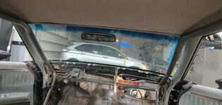

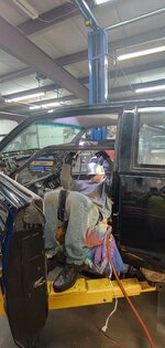

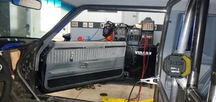

So as the home remodel winds down I tore into the GN. We cut out the cage removed the body and took the chassis to a friends shop to put on his chassis table to straigthen and put in the new Merillat rear torque boxes and upper crossmember.

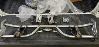

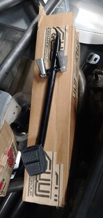

The GN project has been slowly moving along but is about to start making ground soon. I got the frame back from my chassis guy with the rear x-member installed and I also got all the parts for the drivetrain and suspension from Trick Chassis. I had the frame sandblasted and its at another friend shop getting a coat of epoxy primer and I plan to start cutting boxing welding on it this week.
I have been collecting a lot of parts and at this point have just about everything I need to finish the car including all the cage material. I will post pics as it progresses and the parts as they get used in the build. I did get a new turbo a Bullseye dual BB NLX88, it is pretty cool piece can can't wait to try it out.

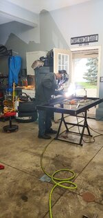

I finally got all the equipment I need to start bending tubing well sort of I am still waiting on a air hyd ram from HF but plan to just use it manually for now. My 1.5" die showed up last week and I have a 1.625 die already which should be all I need for this project.
I got the swag offroad air hyd ram conversion kit that uses HF ram #56215 which is now made of unobtanium. At one point I was able to order it online and they shipped me one that FedEx lost and the replacement is on BO. The swag kit will use other makes but it needs to be a certain size so only a few will fit. I was given a list of them but they are all at least twice the price as the HF unit and probably from the same Chinese factory.
I was all set to build my own custom stand for the bender but found this one from TrickTools and really like it so far. As usual I can't buy the material to build it for what it cost and it didnt even take 10 minutes to assemble.

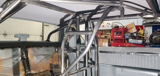

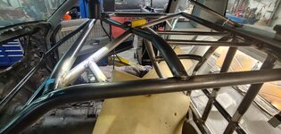

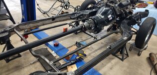

Well the GN project is moving along slowly but moving. I have most of the floor bars in and plan to drop the body back on this weekend to final fit everything and then it will be time to finish welding them. Motor is at machine shop and pistons FINALLY showed up so I will probably have that back soon and have a lot of fab work to do there with accessories and new turbo.

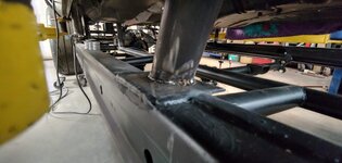

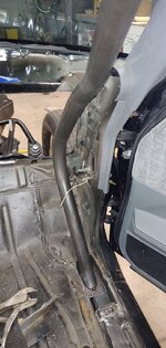

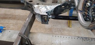

Got some more work done on the GN. Plan was to channel the inner frame rail into the rear floor pan and drop the body back on to test fit all the new bars before final weld. We also had to check the rear tire clearance as I have it set to ride ht and narrowed the rearend a little. What should of been a 2-3 hour job turned into an entire day where we had the body up and down so many times I thought I was going to wear out the lift lol! Ended up having to re-do the trans crossmember entirely along with a bunch of other tweaking and massaging, but the body is back on now and fits nice. We loaded the car to take it to my buddies shop to finish the floor bar welding and once again remove the body and re-install it. Once that is done we will be able to start on the main roll cage.

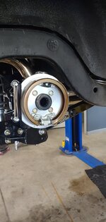

Went to work on some of the issues with the T-type starting with the brakes
Talked to Hawk today and got DTC-30 an 60 pads on the way. My Baer brakes came with Hawk HPS street pads. He said the DTC-30 pad will be significantly better and better for auto-x but not great for road if heat gets over 1200. Very helpful company actually answered the phone too.
I got the new rear brakes on and now have 12" rear rotors with 11" front. I dont see how I cant get a 12" rotor up front to fit with my 16" wheels and plan to research it this winter. Baer said they used to make it but dropped it when going to 13" front and the 13s will require me to change wheels. The 1LE camaro and 89 TurboTrans Am came with 12" rotors and 16" wheels so I am sure there is something out there I can make work. I also ended up with an extra pair of 245/50 R888r's on the cheap since the company I ordered from screwed up and sent me an extra set by accident. They are going to discount them pretty steep to not have to retrieve them. So I am sticking with my 16" rims for awhile lol!
The brake install wasn't without issues and directions eehh but it was straight forward and I am really impressed with the quality and design. I had to drill 4 3/8 holes in 1/4 steel axle flange it is amazing how nice a brand new cobalt drill bit works over a worn out one. Had a few snags with bango fittings and e-brake cable and Baer is taking care of it and I bought this kit in 2017! Great product and service IMO.
I also scaled the car. With 180# driver and full tank of gas it was 3685# which is what I guessed. I played with rear CO settings and got left to right at 3% which was over 4% when I started. I am going to raise the left front some and re-scale it I think I can get it down to 2%. I can bring left front up .25" to match right side ride ht with driver in the car which might do the trick.

As of today, we got the frame completely welded and final paint done. Also got the firewall repainted and the body dropped back on the frame and started roll cage with main hoop done and start of FC cage.

While I have been making progress on the GN things have stalled and at this point I am behind the deadline for making it to Sick Week at least with this car. We were close up to the beginning of November. We took a break to take the T-type down to South Carolina for a drag-n-drive event so I have a lot of updates to post. I will start with where I left off on the GN and that was bending the A-pillar bars and getting the main cage in the car.
The A-pillar bars which I new would need three bends and need to be 7.5" in length. This was going to be the most difficult tube I needed to make and not a cheap one either considering an 8' stick of 1.625 .083 CM is $105!
The issue with the Gbody is the angle of the windshield and getting it tight to the Apillar is difficult you have to put a third bend in the bar to get. I used PVC pipe as a template which didnt work so well but it did give me a rough idea.
The first attempt I didn't bend the offset into the roof A-pillar bar and since you need both to match I bent two 8' pieces at the same time. We did get the one to fit pretty decent but it took a lot of tweaking and was not exactly how I wanted it but it worked. Problem was there was no way to match it on the drivers side bar.
This was the main issue with no offset bend at the top we just kept tweaking it on the other end. Where it would have come out on the dash would be to low and making it the same on the other side with a dash bar would have been impossible.
After wasting an entire day trying to fit the drivers side bar like the passenger one we made I gave up and tore it out.
It took me two tries and an extra 16' of 1.625 .083 wall CM tubing but I finally figured out how to do a 3 bend tube with an offset and it worked out really well.It. I pretty much had to figure it out on my own too, I had even asked a bunch or people and most said they just bend them to fit or used a halo design which I didn't want to use. I did the drivers first starting with bottom 80 degree bend then 14 degree a-piller bend then 32 degree roof bend with 14 degree offset. It literally fell right in the car!
I was able to bend both bars exactly the same and got the fit nice and tight to the body and about as high as you can with the dash to windshield and the dash bar to intersect both A-pillar bars at the same point
Next we finished the dash and windshield bars and actually managed to weasel the entire front cage out of the car to finish welding it on a bench.

After getting the front cage back in the car and tacked up to the main hoop and floor the next step is to make the Funny car cage and finish the roof bars, then the fun will start when we have to lift the body in order to weld everything 360 degrees.
First up is the main hoop for the Funny car cage and in order to do that we needed to fit the driver. So i decided to start fitting the dash and drivers seat.
1031222115a.jpgOnce the dash was in I got the seat mounted and started figuring out where I am going to be and where everything would end up. First thing we noticed was the drivers seat had to move more inboard and the sheer brackets I bought to mount the Kirkey seat would not allow any side to side adjustment with the factory floor mounts which they were made. We noticed they had enough room on the inboard side but none on the outboard so we cut the feet off and reversed them and re-welded which put the seat exactly where I needed it and also gave me a lot more room for door diagonal bars and window net which is always tight.
I also decided for getting in and out of the car it would be A LOT easier if I moved the seat back as far as possible. Being 5'7" would make reaching the factory pedals difficult so I mocked them up too and sure enough there was no way to get the gas pedal so I went with one from SW which will mount off the dash bar. It looks like I will be able to modify the factory brake pedal bracket and will still be able to keep the firewall mounted master cylinder. I also test fit the steering wheel and with moving the seat back the steering wheel will end up to high so it looks like I will be making a new mounting bracket for it or modifying the existing one.
Now that I know where I am going to be in the car I can actually start figuring out where the forward funny car cage bar will go and how it will mount. This is another 3 bend 4.5 bar with bends in different planes and I wanted to make a template first. The PVC pipe I used for 1.625 to make a template for just didn't bend right and had something like 25 degrees of spring back so it was difficult to get it right. I never came up with a steel pipe/tueb with an 1.625 OD cheap enough to use as a test piece but I did find 1.25 electrical conduit made of .070 wall steel with an OD of 1.51 to work with 1.50 CM. While it was a tight in the die it still worked really pretty well and 10' of it at Lowes was only $25. I was able to bend up two FC bars with a 10' stick and good thing because the first didn't work and the second was just about perfect and I was able to duplicate and bend on in CM with only a small tweak.
I did bend the CM version of the FC bar but still haven't installed it. I also bent fit the rear down bars and some of the roof x-brace and once I finish fitting those bars it will be time to lift the body again and learn how to tig weld while inside a car which we are not looking forward to. I did pick up a few new items to make that process go smoother, one of them being a finger trigger that you press on like a pedal to increase amperage which I plan to install this weekend and try out for the first time.
The other is bendable tungsten which I didn't know even existed till my buddy sent the pic of how he tig welded his cage to the frame.
The other was a switch to Furek #8 glass cups which really improved sight along with a #9 CK troch head vs the larger #17 that came with the welder.
Hopefully this will make the next stage go easier. My buddy Ray has done all the TIG welding at this point and has gotten really good at it. He was an ironworker for 20+ and has a lot of welding experience, while my day job has nothing to do with this stuff and everything I know I learned from youtube lol!

Well I think I started talking about building my weld/fab table on page 1 of this thread in 2019! Well here it is my offical GJ shop table build lol! While Ray and I drove hundreds of miles around SC we discussed the GN build quite a bit and one thing that came up is I needed a good fab table in my shop. Problem is the material is stupid expensive and hard to find locally. Ray offered up a bunch of scrap angle iron he had from his ironwork days and he said just go buy a top. So this was my first project when I got back.
I have obviously thought about this project a lot and came up I wanted 3x5 table that was mobile. Ray had a bunch of 4x4 .500" shipping angle and 3x3 .125". I decided to build the frame out the 3x3 and make the legs out of the heavy 4x4. While a lot of weld/fab table builds on here are extensive I just needed something simple and sturdy. I wanted to be able to weld on it, clamp stuff to it, mount a vise on and have a solid surface to work on.
I had been digging this Evolution saw but after seeing how easily it cut 1/2 thick angle iron I was impressed.
I made the legs 32" figure 4" for the leveling casters I was planning to use for a 36" tall table. I boxed the lower 7" of the legs to use as a support for the shelf and to plate the bottoms to mount the casters. We started out Mig welding it with .030 wire and a Vulcan MigMax 215 while it worked fine for the 3x3 stuff the 1/2" legs could use a little more heat. So, Ray being a former Ironworker decided to try out the stick welder function that came with my Alpha 201xd Tig welder. So I ran to HF and got some 7018 electrodes and Ray went to town and I learned how to stick weld.
The angle iron had been outside for a long time and was rusty. I cleaned it and painted it with Rustoleum rust converter which is a perfect flat black for a work table!
I got the casters on Amazon and they are pretty nice. They are leveling and roll nice and are supposed to hold 3300# so when the GN is done I should be able to park it on this table lol!
I ended up going with a .125 thick top as I could easily source it locally and they were willing to cut it to whatever size I wanted. I initially wanted 3x5 but then made the frame 57x33 and decided I needed more over hang for clamping stuff so ended up with a 66x42 top. I was initially going to make the shelf out of expanded metal but that idea was short lived. I ended up getting a piece of 3/16 plate for the shelf and built the frame out of 3x3 I had left over.
And now that it is done I don't know how I lived without it!!

Picking up were I left off with this build. I had the Funny car bar bent before we left for South Carolina but we needed to fit it, cope it and weld it in which is a pretty big task. It is also a very important bar to get right since a lot of other bars and the driver and built off that bar. On one end we needed to tuck it up high and attach to the Apillar bar at a bend and angle and finish at the other end where it will be coped and welded to two other bars.
mlyonsdc
Nov 23, 2018
238
USA
The differences between a 25.5 and 25.3 cert on a car that retains most of the stock frame, floor, firewall, and body are pretty minimal so building a 25.3 spec which will cert the car to 3600# and 6.50 et makes more sense. While I am only planning to run mid 7s with this combo I know how this hot rodding stuff goes and if I ever decide I want to go faster it is almost impossible to upgrade a 25.5 to a 25.3 once the car is finished. Most of the differences are bar diameters being larger with the main difference in the roof structure. The 25.5 only requires one cross bar in the roof and 3 gussets while the 25.3 requires a full x-brace with 6 gussets all of which are also larger diameter tubing. How much more work can 2 bars and 3 extra gusset be lol!
My first go around with the x-brace was all wrong and I had to tear it back out. Good thing I ahve been in contact with the chassis inspector because I would have never known unless he called me after I sent pics and told me. While it was wrong I actually wasn't wrong but the book was!! In the 25.3 SFI book states the x-brace must terminate within 3 inches of the corners and on the FC side it can terminate on the front horizontal portion of the 41B FC bar which is the main FC bar we just installed. But the diagram which shows different roof configurations the leg of the X that would be in the drivers side could terminate on the main hoop before the FC no where near the 3" from the corner. The book also doesn't tell you that it dosen't have to be an X at all unlike other X bracing in the spec which has a lot of specifics about their construction. With all the goofy roof lines the roof X can be many different configurations. SO my first attempt was wrong and good thing because I wasn't crazy about it and it hung low while we had everything else tucked up high in the roof.
This was how I planned to run the back leg but actually would have had to go through the FC to the back corner which wasn't going to work.
At this point we are getting close to the point where the fun will start and we need to lift the body and finish the welding and roof structure. Since my job has been all the tubing cutting fitting and coping while Ray has done all the welding we decided to move the car back to his shop since most of what we need to do is welding. Once there we we were able to raise the body and I finished making the rood bars and gussets and even got the thumbs up from the Chassis Inspector before finish welding.
With the body raised Ray was able to get some nice welds on the roll cage feet. We plated the frame at cage attachment points to give a nice clean metal and strong attachment points
Whoever said if you want to learn how to TIG weld on a race car practice welding under your kitchen sink wasn't kidding!

Once we got the body in the air we also found some issues we went aware of the biggest was some of the gaps on back side of the bars we installed. While we couldn't actually see the gaps we could feel them and we thought they would be ok but once we got the body up two of them were pretty bad. The one for the FC which while it was bad it also easy to see and get to. The other one was on the back side of the A pillar bar where it meets the main hoop. The problem with this one is it isn't easy t see or get to and we were really concerned with how to fix this one. We think the FC one ended up being bad as a result of welding the rest of the bar before it was fully tacked on both sides. The one on the back of the Apillar was probably from welding the front part of the cage out of the car and when we put it back in the bar left a larger gap than when we first fit the bar.
Ray was able to fill the one on the FC by building the weld up. 4340 steel is very hard and you have to watch over heating it so it takes awhile to do this since you fill it, let it cool then make another pass. You can see the large gap in this pic after we raised the body
Here it is welded up, along with the finished roof bars and gussets.
The gap on the back of the Apillar bar was worse and we had to get a little more creative to fix. I made a really small wedge and was able to fit almost perfectly into the gap. Ray was able to lay two welds down to fill it in after that.
The repair
So in my previous post I showed a bunch of tools I bought to try and make this job easier and we ended up using some of them. The Furick #8 glass cup wiht stubby gas lens was a sure winner, the glass brightens everything up so you can see better, the gas coverage is excellent even when you have to stick the tungsten way out there.
Ray didn't use the trigger, mostly because he is just so used to the foot pedal at this point the finger trigger just has a steeper learning curve to get used to. I like it a lot though and plan to use it more often. We haven't tried the flexible tungsten yet as we were able to get the body plenty high enough to get to the cage feet. There are a few dash bars we may need it for though.
The clear winner in tools for the job was actually a pair of welding goggles I bought on Amazon from Yeswelder. I spent a bunch of $$ on the Optrel welding helmet but when in the car there simply isn't enough room for it and you to be able to see. They come with a face shield which got chucked for the same reason the helmet did. They work pretty well over all though and price was right
When I took the car down to Ray's we discussed getting it back to my place and done after the holiday's. But when Ray gets rolling on a project he will work on it either till its done or he drops literally. The guy wont even stop to eat. I left him Saturday at 4pm after we finished fitting and tacking up all the roof bars and the only thing remaining to do was welding. He told me he was going to clean up and probably grad dinner with his wife and he was going to take a break on Sunday. He calls me at noon on Sunday and says he needs help with the car. I run down to his shop and he almost all the welding done he is still in the same close he had on Saturday and his face is totally sun-burnt with goggle eyes from all the welding with out a face shield or sunscreen! So on Sunday we wrapped it up and put the rear down bars in from the main hoop through the rear speaker deck to the coil over x-member on the frame and we set the body back down on the frame for which will probably be the last time.
It was a nice feeling, the hard work is done! We have a few welds up top to finish that can be done with the body back down. It will be moving back to my house for the the door diagonals, outside FC bar, kidney bar and dash bar gussets and the 25.3 roll cage will be ready for inspection. The remaining bars are pretty straight forward and going to be WAY easier to weld. I am also adding some additional bars in the back for the parachute mount and to strengthen the rear structure. We decided to not add the forward clip bars in the engine compartment. Mostly since this is going to be a drag-n-drive street car and I want to retain the windshield wipers which the one bar would run right through the wiper motor mount.
