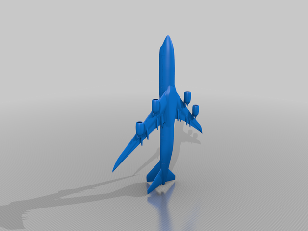

I was given this as a gift. Its pretty cool but one of the 4 engines is gone. Is there any way to replicate the engine and make a new one? I do not know anything about 3D printing but it seems it would be perfect for this. The cost would be a factor...I think this came from a garage sale so its really not would spending more then a hundred bucks or so...

Is it a Boeing 747? Could clip it from these files and print.

There's an engine file in this thingiverse file. Would just be a matter of getting the scaling right for your model. Just print the model then measure your item and rescale it to fit.
Then finishing it and painting it.
That's one of the great things about 3d printing - scaling something is as simple as typing in a scale. I printed out a Church for my and n-scale train layout - was too small - printed it 1.5 scale - too big, printed it again 1.25 scale - perfect.
