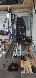

To get the cable chain out where I wanted it used EMT cut to the necessary length for a spacer with a bolt thru it...functional but not overly refined
Better shot of the X axis and how that worked out for the cable supports. I would have liked to have had the emt more centered but didn't work out that way and I am going to redo this axis substantially after it's running and I learn the software side so it should work for now.
And backside of the Z assembly. Mess of wires as I've kept cables long as I don't yet know final routing etc so have zip tied some up to keep the cords from dragging when I try to jog it around.
Minor accomplishment tonight was getting the z axis stepper rewired with that terminal strip mounted on the backside of the Z axis and the proper cable fished thru for it. I had been just using the 6-ish ft cord it came with but as I get things more permanently wired and the X axis cable carrier is on I could get that a bit more functional and not risk jerking wiring out if I sent it past the limits of the temporary wiring.

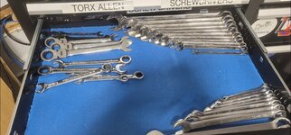

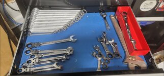

While working on the Volvo I realized how horribly inefficient the tool storage setup I had concocted was and needed to make some changes. No great pictures but originally my 42" roller and a 24 or 28" wide Vidmar were within a couple feet of each other and hand tools were across both. Well they're now in opposite ends of the garage but no logic to the location of tools other than qty and drawer size...oops.
So in classic 5S mentality I started by Sorting and dumping a lot of **** that should've been thrown out long ago. Not done yet but made a good start. Busted screwdrivers, the cheap Allen keys with furniture....cheap and incomplete sets of this or that and those random pieces or trinkets that found a home in the toolbox but never a use....that opened up some space and at least made feel a bit accomplished....sorry didn't take pictures of the pile of **** that disappears tomorrow on trash day
Then it was trying to put tools close to point of use. The 42" box will be primarily mechanic hand tools and the Vidmar will be mostly fabrication stuff but will probably have some hand tool duplicates where it makes sense.
Sorting thru the combination wrenches and trying to get them all in 1 drawer for now. I've tried a variety of storage methods and racks, long term I want to do foam but for now will likely be a basic 3d printed holder keeping them vertical and pretty tightly stacked for the best density. Hoping to get the complete full set of up to 1-1/8 or its foreign born cousin, plus a couple smaller sets of ratcheting in both Imperial and Metric into a single drawer...right now its across 2 of them as I didn't realize how dense I could get them if they were completely vertical.
Consolidated screwdrivers down as well to the large set of Tekton, plus probably the Whia insulated and maybe a Klein 10 in 1 for this box....before there was at least 4 sets plus singles rolling around with no organization...ugh. Again planning to 3d print a holder to lay flat and hold the shanks about as shown here. Allen key sets, probably scraper and pick set and some other stuff will end up here as well. Would like to put the nut driver sets here as well but don't have room. The Vidmar will get 1 or 2 smaller scrwdriver sets, plus the metric and standard sets of screwdriver handled ball end drivers.

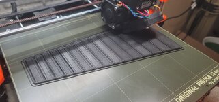

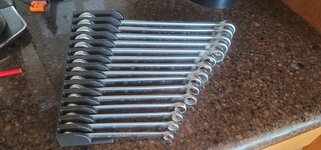

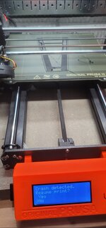

Well yesterday's print failure gave more time to model my own wrench rack with some inspiration from Google...
Looking good...
Until this screen in the midst of the print with an error....
Grrrr....
Attempted to run the same file again, a Bed temp error occurred almost immediately so to troubleshooting I go. Looks like the wiring lead for the thermistor controlling bed temp is bad, replacement assy is cheap at 6 bucks from the manufacturer but have to wait till end of next week likely to get it. Tried to find a faster domestic source but they were enough more money and not that much faster so I ordered 2 of them and a roll of filament I had been wanting to try anyway so more time for other stuff and CAD time and hopefully fixes the issues I had been seeing

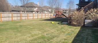

Anyone want some landscaping practice?
10 ish yr old landscape bed, don't agree with really any of the decisions on what they put in it or the design but it's what I got to start with. It's on a corner and there was a small tree and a bush blocking sight line for cars so I removed those last year but past due time for a new retaining rock perimeter to hold mulch back, then new landscape fabric and some new plants...if I'm lucky I get fabric down and plants in today. Don't have the rock for perimeter or the mulch yet.

Hope you got it all done before the heat hit you today and most of the rest of the week! I wish I could say I got more done than the picture above....but yeah that didn't happen. Almost took the toddler out to stick him on a blanket in the shade while I worked on it but didn't....hoping bed time routine goes well tomorrow night and I can get an hour or so out there and the landscape fabric down.
Definitely a good idea to help people see better at the intersection.
Agreed...I'm honestly surprised the landscapers put what they did so close to the corner....i mean the corner street sign is literally in the bed....but whatever. If I had more time I'd honestly rip out half of it and put it back to grass....but I don't so I'll slowly make do with we've got.

Shared the file for the wrench rack with my brother and he tried it overnight on one of his work printers. Holds the Craftsman wrenches which are a bit thicker than the Snap-On it was sized for a bit tight but not bad and leads hope it may work without revision for the Snappys and maybe the Wrights
gearhead1960
Mar 21, 2019
1,835
You taking orders yet?

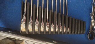

The wrench holder looks good!
Thx sir!

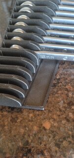

Timing worked out and I didn't have to stay up past my bedtime for the printer to finish the wrench rack
1/2" to 1-1/8", not sure where the smaller sizes are... may not have ever had them as this was a used set I got years ago
Height clearance is close, but there is also a 3/8" or so piece of foam raising things up, so without that probably do have clearance for a couple more sizes vertically
Fit is pretty good, the 15/16 needs opened up a bit but otherwise it seems to be a good midpoint between moving around and too hard to drop in. Also not hard to grab one out, but I didn't try with oily gloves on either
The slots are too narrow for the Wright and Craftsman sets I have, but all my Gearwrench ratcheting sets fit comparable to the Snap-On
Couple improvements are already done on the computer for .Rev1, will look closer at slot width in the morning and get another one going sometime tomorrow!
