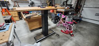

Tossed a desk top on... cause why not.
Looking like approx 20" of travel, won't get much lower than 33" or 34" with a top and casters. Need to look at the caster selection and determine what I have toe brakes for or if I need to buy something.
While playing with it, discovered an odd noise, appears a bushing on the lead screw nut is turning causing some knocking so will have to do some disassembly to figure out fixing that one. picture shows the top side of it

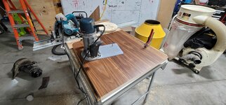

Well actually doing something....mostly reinforcing the priority the dust collection needs to be...the highest
Wife is an interior designer and one of her big projects is getting to trim selection and the profiles the client likes are of course ones that the builder and the millwork shop don't have on hand...so 6 weeks for samples. She asked if I could 3d print some but after seeing the profiles I decided it would be easier and better to just make from wood as they're all pretty modern without any big curves
Laying them out on a piece of 1x8
Cut down to 8 to 16" pieces depending on how tall the profile is
Shame I don't have any flat work surfaces that are clean...
Go to load an 1/8" roundover into the router....hum....anyone notice anything missing?
I remember my son playing with the yellow safety key...but I'll be damned If I can find it. So bypassed the switch and will get to look more later...then go see if I can find a file online to print a couple. Next one will get a lanyard to tether it to the machine
Think in an hour I have 5 of the 10 made and half done on a couple others. they'll get a couple coats of white rattle can when done...goal is to have them done so they can narrow down to 1 or 2 on Tuesday

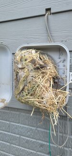

Not positive on this next one...but I don't believe that telecom connection boxes are supposed to serve as housing....fortunately I'm not in California so eviction was easy :)
I've got some wiring cleanup to do...and yes the nest was empty

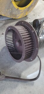

Attempting to take vacation today...will see how effective it is....so to the garage
Motor off:
I had seen the squirrel cage type fan blower and wasn't excited about it but now that I see there is a center pipe down the cyclone preventing the direct contact of heavier chips/debris with the fan I'm not as concerned...at least satisfied enough to try and get it running without changing impeller first
