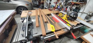

Trying to keep going on the marker board. I just "happened" to be driving past the local Woodcraft today....couldn't not support a local brick and mortar and their prices were actually spot on with online...so a few things followed me home
Got the perimeter for the first board jointed then ripped to 2.5" wide.

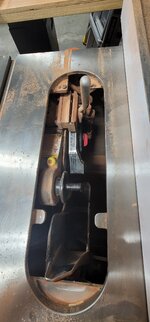

First time swapping brake cartridges...pretty easy. New dado cartridge going in...one of today's additions
Measuring up the stack
And after an anxious flip of the switch without a brake activation, then running the blade up and putting a bit ole cut in the nice and pretty new ZCI...again another addition today.
I had planned to put the groove in without the dado stack...but I owned the dado stack already and needed the brake and new zci so said screw it and just bought them

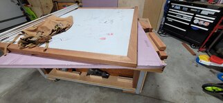

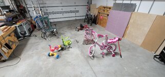

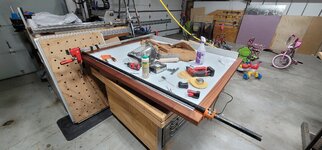

Another thank you to Mr. Carrier....providing additional space for the kids to leave their toys and stuff in ;) It really is great to be able to have them spend some time in the garage with me while I putz and they ride their bikes around in the empty stall...they hate all noise(even drills) so it's mostly cleaning time but still a win
So did end up tossing Danish oil on it last night...safety reminder to be cautious of your finish waste...I may have knocked over the can and had to soak up some spilled finish with sawdust so tossed all the trash and rags into a bucket with water and into the yard overnight. Plastic bucket...not ideal...but it was out in the middle of the yard in water so it made me feel better. Going to have to keep an eye out for a metal lid safety trash can on marketplace and Craigslist.
Few tools collecting thanks to my FSD flaring back up....note these are all actively in use!
1-1/8" screws from the backside, thru the MDF backer/metal markerboard sheet and into the exterior side of the groove to help secure the markerboard well. I also stuck a #10 or 12 x 3.5" long screw down vertically from the top "rail" down to the stile to help secure that together.
And lugged up into it's home....it's heavy...guessing at least 60 lbs...and awkward to move. I'm debating on hanging methodology...the easy way would be to screw thru the face of that top rail with some #10 x 3.5" screws right into studs. Finish width is 62" and studs are on 16" centers so I can easily grab 3 studs. Other option would be to put some L bracket/hanger hooks into the backside and go for a more concealed look...but I'm still hesitant with that and kids and would probably still stick at least (2) screws thru into studs
The frame looks great! I like that table.
Thanks...after I finish up cleaning up the mess and a bit of CAD work I need to do making the next steps on that table I think is next up before I do the other markerboard half

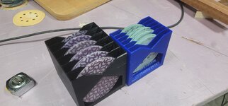

I’ve been using some from Klinspor and liking it compared to the Diablo from Home Depot. Can’t say how it compares to Mirka.
Nice work on the whiteboard!
Saw a number of good reviews for Klingspor product, it'll be on the list depending on how these others work out
Check out Search Serious Grit on Amazon (recommendation from @nicholam77 ). When my current stash need replenishing I’ll experiment with this stuff.
Festools granat is also good but spendy.
Thanks! Ended up ordering (2) of the assorted grit packs of 3M Cubitron
It's hard to go wrong with 3M products, coupled with solid reviews and this interesting review from Katz-Moses
Also thanks to the recommendation picked up the assorted pack from Serious Grit
Should set me up for a couple days...delivery on Monday so see if I can get to trying it out by end of the week.

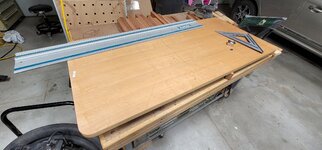

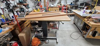

Tonight's little project was a base for the drafting table
Piece of the plywood desk tops retrieved from the stash and laid out
Tracksaw makes this easy
And success
Cutout on the front is for the up/down switch, its foot activated at the base of the column. Plan to attach to the metal base with self tapping screws, then will mount 4 swivel casters to it. Still unsure what I'm going to do for a toe brake to keep it from rolling around...though with on-board compressed air...pneumatics sounds fun!

Looking good. What about a floor brake, like this?

Board is looking good with the nice wood trim!

The whiteboard turned out out great! I think @Boostingaz idea for the cleat would be good. Or French Cleat, but wouldn't be as low profile.
Thanks! I have an idea of what I'm going to do different on the next one....will see how that goes!

Quick CAD model for some sandpaper holders inspired off @slodat shipping bag holder came off the printer this morning in blue PETG
The slots are a 1/2" deep and these discs really like to stick to each other, so there is another one finishing up shortly with 1" deep slots to give a bit more room
Also managed to get the plywood base anchored down to the metal frame with the usage of only 2 colors of power tools and a few more than a dozen self tapping hex heads
And there is a built in set of (2) pass thru power outlets in the base so I went ahead and stuck in a 2" hole thru the top for that....probably should've grabbed a hole saw bit for this instead....

Your comment about the floor slope.....
I'm so glad my floor is flat! It was a bit of sticky point and took some polite "arguing" but I got it approved. They were taking the stance that since I have an overhead door, it needs to have a sloped floor. However, I finally got it through to them that it's a shop, not a garage, and if there is no vehicle storage it doesn't have to be sloped. It helped that on the blueprints it was very clearly marked "shop" and "garage", both sides were labeled differently.
The shop is flat but the other half of the building because it is indeed storage is sloped.

Hey look...it rolls!
4 wheel swivel casters....overkill on the 3/8 x 1" lag screws....wanted some short GRK style structural screws so I wouldnt have to pilot but none at big orange box so these will do
Freshly greased and it seems to roll nice but will need the brake. Think I found a spot to put a toe brake...now to see if I have one on the shelf
And the larger sandpaper holder got done...the larger slot is far more gracious to remove sheets from...so another one is printing overnight
Now that you've got two, I have some suggestions: How about label holders to ID the different grits in the slots? Or including label text on the print itself?

That mobile drafting bench is turning out pretty neat. What's its role? Just a general surface? Assembly? To @madison069 's point earlier, it seems like that floating bench top would have a good opportunity to hang some oft-used tools right at the station, like the small clamps you were talking about, maybe a small drill or two, nailers, could even 3D print some storage for consumables like glue or tape if that's in the cards for how the work surface will be used. I'm interested to see what you do with it — with how open it is around the base there's lots of room to store other stuff besides the compressor, like tool boxes or power tool's in cases (sander perhaps?) at the station you'd be using it (if that's true).
