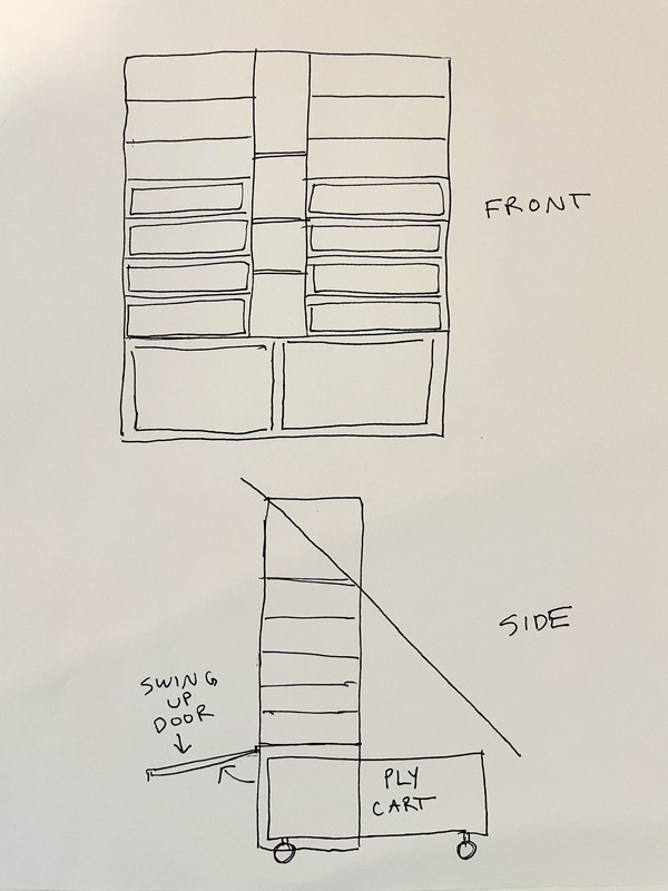

And that's where I'm at so far...so what ideas does the GJ hive mind have on how to maximize that storage space in that back area? Top ideas I'm spinning on right now are:
  1. Custom drawers at 40-44" deep with lesser used stuff in the back
  2. 24" deep casework and access door on "end" to slide stuff in that back 24" from the other side of the closet
The drawers would give more "usable" room but those would be darn spendy drawers with the plywood and full extension slides for that size. Other option is simpler, but not as convenient....so what says the brave few who got this far in the pictures ? Open to any and all ideas...wisest which would be get less stuff but I'm not going to broach that idea!
I think any solution taking advantage of the full depth is not going to be super practical for oft-used stuff. I totally understand not wanting to throw away that extra space, though. I think it sort of depends on what you need to put back there, but out of the two I would maybe vote for the 24" cases and the side access panel as the easiest option. And then just choose to put more long term "cold storage" stuff in there that doesn't need to be accessed often. Like winter boots during the summer season, holiday decorations, stuff like that etc.
Now get ready for some craziness. :eyecrazy:
Another idea is to raise the cabinets up, and build a full-depth structure below that has some swing-up doors on the front. Then you could shove stuff in the front, or even make a rolling plywood box on some low profile casters to pull out.
Or the lower doors could be removable and magnetically attached or something like that.
Or you could make the long drawers like you suggested and use DIY wooden slides to keep the cost down.
Or you could use the ball bearing slides but just build one huge, deep drawer, so you only have to buy one pair of slides.
Or you could use the doors like that with no drawers or cart and just build a fixed cavity to shove stuff in.
Of course in any scenario, by moving the IKEA cabinets up, you'd lose some drawers/shelves, and it would be more work to build and engineer the bottom portion.
Whatever you do, it looks like a complicated project, and I agree with Bret I will be tuning in to see what happens!

I think Nick's proposal for the raised shelving units, sitting on top of the 'cart-port' is an excellent option. A set of doors would keep it clean looking and not be too expensive.
Larger pneumatic casters (8"?) would make it easy to roll in and out, even over carpet. You could then custom fit the cart to utilize the whole space. Harbor Freight has these for $14.50. Recess them into your cart design for even more efficient use of space. The cart could be a simple flat item, like an automotive creeper, or more complex like a big bin with dividers and inserts.

Logan, is it possible to design a U-shaped set of cabinets with tall stuff on the sides and a low cabinet at the rear in that space under the sloped ceiling. It would mean some triangle-shaped spaces but that might be good for belts and similar items.

Been quiet here for a couple days, but not ignoring ya'll! Thanks for all the input...definitely helpful! No pretty pictures or renders in this update...maybe later tonight
Wife and I had some time blocked out on our calendars on Tuesday night to review where we each were on our progress on the bedroom updates. Unfortunately setting calendar appts with reminders seems to be the most effective way for us to keep progress like this moving....slaves to the corporate mindset and world I guess...oh well
I earned brownie points as I had more done :rocker:....but they were quickly met with :headscrat when I talked thru what I was thinking. As things progressed we mostly got on the same page, fair amount of CAD work and "proving" left to do....but here is at least where we're leaning now.
(2) custom casework cabinets roughly 28" wide x 36" or so deep with a sloped ceiling to maximize space
Full depth drawers on the bottom 30" or so mounted on 36" slides which on something that will probably be a 44" deep drawer will be mostly full extension and a big cost savings vs a 44 or 48" slide
Still working thru the drawer height and lots of revisions to come....but likely going to have (1) 12-14" deep drawer to hold carry-on suitcases, then probably 8" deep for the remaining ones.
Drawers from that approximately 30" mark up to 48" high for normal clothes
Adjustable height shelves from 48" up to the top...likely for a lot of her shoes
I have a fair amount of work to prove/disprove that we'll have equivalent or greater drawer space then we have today....I think it'll be there but will find out as I work up the details
The "gap" between the 2 dresser units is then "scope creep" of a pull out clothes hamper. She's got roughly 20" deep by 36" wide stand up hamper with 2 cloth bags she really likes and I would like it out of sight, so going to attempt to put a 3 bag unit on a set of full extension slides to take advantage of the full depth of that center gap between the cabinets. As yet undecided on what goes above that section....will most likely depend on the dresser space math results and how much additional space we need to find....
And while staring at the project space I realized yesterday that I'm thinking about putting a 28" wide frame/carcass in a closet that has a 24" wide doorway....grrrr
So I'm probably going to have to do final assembly and glueup of the casework boxes in the closet itself which is an added hurdle I hadn't thought of but super glad I realized it early on!
