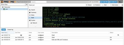

Also thanks to Nick's comment about about using an eBay bought PC for his server, realized I had several unused machines on a shelf. So pulled one out...windows 7 machine if that gives an idea of age
And it won't boot.....go figure
So going to plug in a different hdd to see if that'll make it do something....otherwise it's back to the pile and may try an old laptop

Not having any more success setting **** up on a different extra computer then I'm having using that walking desk....

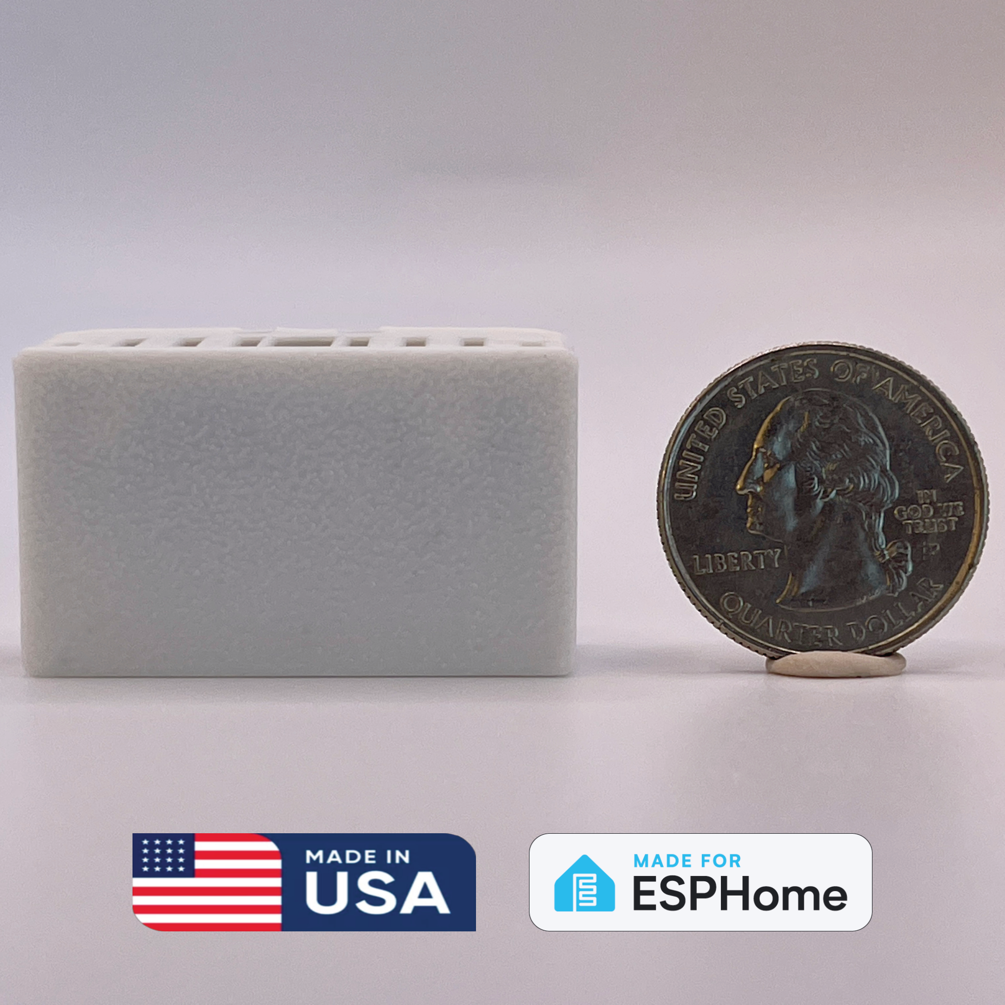

A pair of Apollo Automation's MSR-2's are supposed to show up tomorrow or Saturday so I can play with exactly that.

My patience wore thin today with a sick 6 yr old at home, so a new to me refurbed HP mini pc is supposed to show up tomorrow....after the initial DOA mini PC, 2 failed "pull off the shelves"....4th time is a charm right?
