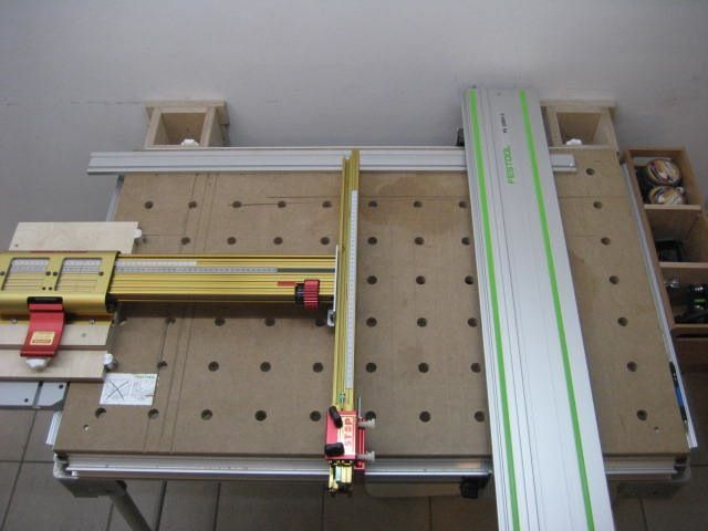

The plan was to use it in conjuction with the MFT...make a bolt on router table "box" that would go on the MFT mobile table setup I made and have the top surfaces aligned, then use the Incra gauge in conjuction with a likely homebrewed version of this:
View media item 112038
https://precisiondogs.us/collections/frontpage/products/precision-plate
So that I can quickly drop it on the MFT table to use for the router, and when I'm not using it for that it pops right off as I don't feel like I have the space right now for a dedicated router table that big

For now I'm likely going to try and use the router table as is since my wife's requirement to park in the garage at night has been temporarily relaxed due to spring so I'm able to "sprawl" into her stall. Hopefully after I get these built in dresser units done I can get the router table "box" built and mounted to the side of the other cabinet and then sell that current table...will see what else comes up between now and then

Cool! You could also use the Incra fence as a rip stop for the track saw, too, on the MFT. Precisely repeatable stops, or incremental cuts for something like dados?
Interesting your 3D printed parallel guides were sloppy. Mine aren't perfect, but also not so bad I felt like it was affecting results. But mine were done on a crappy 3D printer, though, so maybe they weren't as precise of a fit as yours. I'm sure you've tuned them up nice. They aren't the prettiest, but a huge cost savings over some of the commercial solutions out there!
Bingo....though I am a mere padawan compared to you and others learning how to use this MFT style worktable for increased efficiency but the thought of being able to use the Incra with the tracksaw or other items was definitely in my mind.
I doubt mine were sloppy enough they would've impacted the results...when you snugged up the bolt they tightened up well....I was mostly being finicky about it and using that progress to feel better about my procrastination starting the larger project....:shocking:

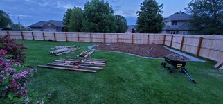

The main playset pad got cut and all rolled up, but hadn't spent anytime figuring out what I was gonna do with the sod....hmmm....
FB Marketplace here we go! Had good success in Chicago with giving away or selling super cheap things that I would otherwise have to pay to throw awag(and invest significant time and labor in) so tried that route again. Just over an hour after posting had a couple backing their trailer in to load it all up!
While discussing their project for it, we talked over their needs and what was loaded up wasn't enough to finish the project so with the equipment already on site...let's keep going
That no man's strip was a necessity of utilities being buried there and not able to get the posts in and I dislike having to maintain it. Was willing to keep mowing it for awhile based on how much effort it was to get rid if the sod...but since I had someone ready and willing to take it...went ahead and did it all as well
That was the end of my energy and needed grass removal so back to return the stuff and pick up the weed control fabric I went

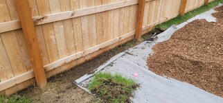

Ran out of barrier cloth about 6' short...grrr. Still need to dig the sod out between the posts so the mulch can go up against the fence

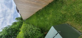

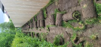

Attacked some of the grass left between the posts
And got most of the set moved back to the backyard

Used the new dovetail groove for my first project fixing one set of the headboards on the twin bunk bed set we picked up from the neighbors... super excited at how this worked!
