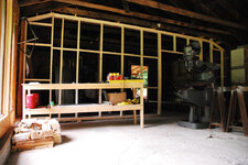

Here's a handful of before/after shots from past to present. Getting a little year end perspective today.
Before (Original state of this corner - the stud wall is where the horse stalls used to be):
During Build:
After:
Before / During Build Out:
After:
9777406702_61c6535b94_b.jpg44 Frame Shop :: North Wall by Kristofer Henry, on Flickr
After:
Outside..
Before:
After / Summer:
After / Winter:
