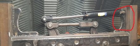

Unless I missed something, the "weak link" in you chain is where your cross piece attaches to the uprights.
This is just like building the the second floor of a house. The joist need to REST on the structure (top plate and studs) below or have auxiliary support (Simpson Strong Tie Joist Hangers). I am not saying it will fail, but it it dos, it will likely be at that connection.

Started the day off proper with a little bandsaw action, the piece buddy had was 54 inches so i cut 4 off. Actually worked out nice having the little 4 inch piece for fitting the upper plate
After that I did some figuring on the doubler plates for the upper punch plate. It will have 4 wheels that will roll on the uprights, I am welding 1/4 plate ontop of the uprights first
I also cut out the matching gusset for the other side of the top
Heres where Im at
I sorted through a bunch of hydraulic hoses I acquired a few years ago and there are 4 hoses that are perfect, 2 about 5 fert long for the ram to spool then 2 more about 15 feet long that I can run to my tractor parked outside. I also had most of the fittings I needed. I went and got some angle iron and flatbar to build somes dies, I am going to start with a 1 7/8 and a 3/4. I think that should cover most of my application. I grabbed some hydraulic quick connects that were the wrong ones so ill have to try and find one of those.
I think you missed these?
If this isnt enough ill pick up a couple 2x4s and some 3" deck screws to beef it up

That gusset will add a LOT of support. I assume you are going to weld the other side also.
Yes there is a gap on the right side for a 1/4" doubler, that gets welded on then I run a hot nasty pass of 6010 in deep on the gusset to doubler then fill out with 7018 probbaly 5 or 6 passes . The 6x6 joint to the upright will also get probbaly 4 passes of 7018

Is there any adjustment for level built in yet? Or do you need any?
I measured yesterday and the punch is out about an 1/8. Once i get the die bed on (hopefully today) I will zip the rod and shorten it until its level then re weld

Got all the gussets welded up this morning. I was going to lay it down and flip flop but decided I would give it a shot in position, once I dialed in the heat they didnt turn out to bad
Then I went on a goose chase for some hydraulic gear, finally found the right couplers for my tractor
Once I get some legs on this thing and at the height I want ill mount the lever temporarily on the upright. eventually it will get switched to a foot petal of some sort

[looking good! That's going too look great once it's painted. Is there going to be any adjustment from one arm to the other so it's parrallel when bending? And are you going to add the hinge points with grease fittings? /QUOTE]
Also where in Ontario are you situated? When you stated your a few hours from the plasma tech guy, that the same as me. BCD.

I made the adjustment today, I cut the arm and shortened it about 3/8 so now its as close as I can get it with a tape. Im going to pull the pins 1 at a time when its all together and know it works and drill for grease *******. I'm in wyoming, between sarnia and london. Do you have a plasmatech table?

Well today I made some good progress, I started by turning some wheels for the punch to roll up and down on
Then I started pounding rod to the punch, I was moving around but wasnt flipping it over because the thing weighs probably 100 pounds. I finished the one side buffed it all up and when I was flipping it over i just happened to look down while it was standing upright and the thing looked like a banana. I put a 4 ft level on it and there was about 1/4 in the middle...well no turning back now haha I cranked the heat up a bit and hussled on the back. I got lucky, it was only out about an 1/8 when I got done and thankfully my log splitter took care of most of that then i had to do a bit of grinding in the groove
Heres a shot of the punch all assembled, I drilled and tapped 8 holes and have some set screws holding the punch from falling out. I also welded a tab to keep the dog bones together, this was a huge ordeal also haha i was hoping to put it inside in the middle but because of the angle when the arms are up it just wouldnt work, im not crazy about it but it is what it is
Then I gave the clevis a little slice to get the punch sitting level
Starting to come together
Probably not going to work on it much tommorow but Monday i need to weld on the doubler strips where the wheels roll, then the die bed needs to get welded on, whip up a quick die out of angle and see if it folds in half. I need to make some legs too, I want to come up 7 inches. I might need to get the nieghbors skid steer to move the thing im not sure the baby tractor will handle it

Great strides were made today,I got the die bed on, the 1/2 plate on top, im out of 7018 so I ran a quick pass of 6010 on everything
This is the die i whipped up for now, has about a 3/4 opening, I lowered the press onto the angle to center it and also keep it from warping then tacked it up. Ill finish welding this week
Heres the buisiness end of the whole deal
Here is my first bend, 4 ft of 16 ga. It did this at about 300 psi on the gauge. chart says 2.2 ton per foot
I was worried about not getting 90 because my punch was machined 90 not 85 like i asked for, it was free tho so we cant complain. Its showing right on 90 but well see with the thicker stuff
This is a 3 ft long piece of 10 gauge, it was building pressure and the punch was starting to deflect out because I dont have the roller guides installed yet. 3 ft of 10 ga in a 3/4 die should be 31 tons according to the chart
In conclusion I think Im getting a whole lot more mechanical advantage than I thought. My tractor is only putting out 1500 psi on a 3.5 inch cylinder thats only 7 ton l, that 10 ga should have required about 30 according to charts so its possible im getting more like 5:1 not the 3:1 I thought.
Tommorow I need to get some more 7018, weld up the bed solid then work on making some guides to keep everything nice and straight. Hopefully in the next few days well be in action

My ram at 300 psi should put out about roughly 1.5 tons, 4 ft of 16 ga in a 3/4 die should require about 8 ton. So my 5:1 math adds up reasonably well
