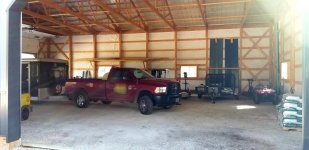

Since the excavator did such a good job leveling of the building pad with the rough grading I set the building grade height so that I would need minimal prep before putting down the foam board and concrete. The problem since I'm still a year or two from doing concrete I am left with a 7" gap at the bottom of the garage doors. Because I have trailers coming in and out I didn't want to hump gravel up to close the gap so I decided I would use 2x8's to fill it. I brainstormed a few different ideas on how to best keep it in place but still make it easy to remove and this was what I settled on.
When I want to come and go I can flip the 2x8 down and drive over it (with all but one of my cars at least). I wasn't sure about backing a trailer over top of it but I didn't have any trouble at all. When it's flipped up I just slide the 7/16 x 3" bolt over on each side and it's held in place pretty securely. It's not exactly mouse proof but at least it is stray cat proof.

So I thought I'd give a quick end of summer update even though there has been there has been no progress of note aside from "moving in." I still don't have utilities run or a floor poured. It looks like it might be a little while before I can afford those but I'm getting good use out of the building. Most importantly it has allowed me to eliminate my prior rent payment for my last shop. I'm not sure if I've mentioned it but I run a lawn service business and this serves as storage for all of my fertilizer, trailers and equipment. I'm really looking forward to when I can use it to work on everything also but for now I'm stuck using my attached garage for those activities. Although it wasn't my intention, I've found myself driving through with the trailers coming in the center door and out the 18' wide door and it works pretty well. After using it for a while now I can't say there is much I would do differently. I might have increased the width of the small doors from 10' to 12', but only time will tell. 10' seems wide in theory given vehicles are only 6-7' wide but in reality it feels tight. Other than that I'm very happy with everything.
20191012_104730_resized.jpg 20191012_105043_resized.jpg 20191012_105213_resized.jpg
