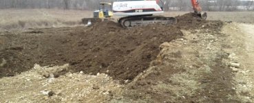

Today he went to work leveling the building pad. After the stripping was done the two back corners were down about 3 feet. He punched a hole next to the building and I got lucky because the gravel layer was 8-10 feet deep. He dug that out and spread it out on the building pad with the excavator and then used the dozer to smooth it out. Then he compacted everything, took out more gravel and doezed it smooth again. I was there taking a closer look at the compactor and he told me it was just like driving a lawn mower and to give it a shot. I went to work compacting everything while he started filling in the hole with the excess top soil. He didn't want to use all of the top soil for fill so he cut some dirt from the back side of the hole to use as additional fill. The grade slopes down in that direction anyhow so it will just be ever so slightly steeper than before. In total he was able to get probably 20-30 truckloads of gravel out of the hole which not only saves me a ton on trucking gravel in but also gets the building a little higher up in elevation than I would have otherwise done. Tomorrow the plan is to strip the remainder of the driveway and let the ground freeze up solid over the weekend so the gravel top coat for both the pad and driveway can be trucked in.

Today the excavator was back to strip the top soil where the driveway is going with his son there to drive the dump truck. He used the excavator to peel up the top soil and load it into the dump truck which drove back and dumped it in the hole previously created next to the building pad. After the top soil was removed he leveled it off with the dozer and went over it with the compactor. He left me all of the top soil in the back and suggested keeping it for now until the project is done at which point he will level it out or buy it off me. Now it's all ready to bring in the stone early next week.

Today the excavator finished up everything. He and his son started the day by spreading one load of stone to ease the drop off from the existing driveway to the excavated portion and then ran 2 quad axles on rotation dropping loads. Thankfully the quarry is only about a mile away so they were able to turn over as fast as the quarry could get them loaded and out.
After about 10 loads he stopped running the quad and started spreading them out with the dozer and put me to work running the compactor while his son was still running loads. He spread it out on the building pad and then checked it with the laser level while I compacted it. He then leveled it out a bit better with the dozer as I compacted the gravel around the building. After that I compacted the building pad once more and then he back dragged it with the dozer blade to smooth it out. He had me make one final pass with the compactor with the ******** off this time and it was good to go. All said and done it is within an inch of level which is way better than necessary at this point in the process.
At that point there were enough loads to start working on the driveway that runs back to the building. He smoothed it out with the dozer and when I finished up compacting around the building area I followed behind him. We ended the day at 19 loads which was quite a bit less than I was anticipating. The big contributing factor was that the building pad only needed a skim coat of crushed gravel instead of a foot like I was originally planning since there was enough gravel on site to bring up the low end. I still haven't received the final bill but it sounded like it will be quite a bit less than I had budgeted.
