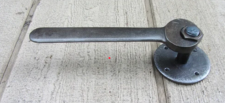

Wife and I have laid the perimeter 4x6 and excavated down for 3.5” - 4” of gravel (3/4” chip). Delivery tomorrow of gravel. Probably overkill, but used Simpson inside corner brackets and 5 1/2” screws on each side. Before laying in the gravel trench, I did paint the bottoms and sides with Woodluxe. The wood is still a bit wet but I figured I can leave the top face of the timbers open for the season to let water get out there. I really wanted to seal the sides and bottom before they got covered forever. I am hoping that having the gravel on the bottom instead of bare ground will also prolong life.
Finally, way overkill, but pinned the sides down with 48” x 1/2” rebar , two places on each side. She is never going anywhere lol !
Three weeeks until shed construction. My best bud from Texas is coming up for two days. It’ll be a fun sprint. Just ordered all the lumber for delivery $1900. A few hundred more expensive for the local family lumber yard and that’s fine with me.
Also finalized the design for the door. Got some lovely bronze hinges finished in espresso brown.
Still in search of a good door handle …
