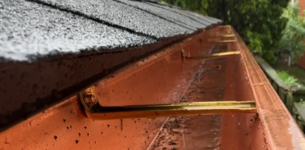

Update: Roof shingles and gutter successfully installed.
Shingles were the same make and color as our house from a few years back, OC Duration in Black Sable. This was really enjoyable to lay down on top of the ice & water shield that had been keeping her dry for a couple weeks.
I hand-nailed with 1 1/4" galvanized roofing nails, while my dad made the cuts. I also made the stagger easy with this template board in anticipation:
A couple tips for the fine details of the roofing:
0. since the visible rake edge of our roof is on the right (image below), i started on that side with factory edges and worked left. this was great, no problem, even though you usually watch folks do it left to right.
1. Make starter row by cutting horizontally and taking the single sheet side (non architectural tabs side).
1b. use that leftover architectural strip as your final course at the peak of the roof.
1c. final course, keep the half shingle width intact and just reduce the reveal. no one will notice this.
2. I messed up nailing the last course, and didn't get close enough to the edge to cover the nail row with the cap flashing / drip edge. had to Henry's seal those nails. no one will see it but you guys in this picture.
3. I used 1.5" Drip Edge for the sides and eave, but due to angle that was not sufficient to cover the roof decking -to-fascia gap. had to go to the store to grab 2.5" drip edge (more like 2", but it worked out ok). I think there's a better way to flash that cap but oh well, it's good.
4. used roofing screws, 1" with gasket, to screw in top flashing.
5. i used my chalk line after nailing the first course, to make a mark 2 courses up. it wasn't necessary and I found by the top I was off about 1/4" across 13 courses.
roofing was fun, but it was my own shed in 50 degree temps! : )
looks nice with the house shingles:
Gutters were easy to install.
Tip: mark on the underside of your fascia where your rafters are, since your fascia fasteners will be covered by the gutter as you fine toon the hanger placement. definitely want to run the 1.5" hanger screws through both the fascia and rafter. especially in my case where there is no added sub-fascia board.
I didn't originally plan on a gutter, but the rain was falling right from the drip edge on to the rear foundation perimeter timber. dumb. so we used it as a change to bling out the shed. haha. our local gutter supply store sold and delivered a copper by-the-foot, with a couple end caps, very next day. It's a beautiful accent to the warm color tones. The vision is the rain chain to barrel, hopefully can find the right barrel soon.
We just had 1-2" of rain in the last 24 hours, with moderate winds. Shed is bone dry, so is the fascia board on the eave side. It's very pleasing to see it come together. i took some video while it was raining. very good angle from the rain.
final tip: although hardly shows in image above, the drip edge was bent out about 1/2" and the gutter flange slide behind the drip edge. 1/2" of slope across 11 1/2' of length. beauty.
Next Up: finishing touches (door sweep, holders, barrel bolts), paint final and touch up coats. caulking.
