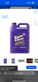

Here is the frame after some superclean and the pressure washer. This is still wet in the pictures, but it looks surprisingly clean when dry. There is some crusty stuff that I will assume is road tar/paving. It wouldn’t come off with pressure. I’ll have to wire wheel it I think. Thanks for looking. Maybe I can get something done before Christmas 🤣
Very nice job!
What is this "superclean" you mentioned? Some sort of degreaser/cleaner?
