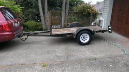

KOD: thanks for the information. i'm just restoring a little 4 x 8 utililty and maybe making 18 or 24 inch sides for it probably out of Cedar since I have some handy.
the little wheel in the front of my old aluminum trailer is what i'm looking for that I think you mentioned isn't good for the bigger trailers or ones with boats on them. yes?

For that trailer, u would have no trouble with the Harbor Freight 2500 pound flip up jack with wheel. Get a 20% off coupon and you could have it shipped to you for less than $30. They work good for liguy duty trailers.

KOD: I've only bought one item from HF (propane brush burner) and that was over a year ago and it's still in the box. my trailer already weighs about 500 pounds and i'm still going to put on sides and possibly a metal floor so was hoping for something a little nicer to roll it around on. also sometimes it's pouring down rain and I'll have a loaded trailer to push into my storage unit so I can empty it in the morning if the rain has stopped. I had maybe 3000 pounds on that little aluminum 4 x 8 trailer at times so would have to make sure it was a level or down hill push into storage if I chose that option.
I don't mind spending $50-100 for one if it's a LOT better than HF's, but if they are not much better I don't mind only spending $30 either because i'll just have more old vintage tool funds to spend.
