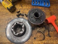

The brakes, as it turns out, were TOAST. I pulled off the front calipers, which were well and truly shot.
I rebuilt both of those, put in all new soft lines, replaced the rotors, bled the brakes…and still nothing. At all. There were no leaks, either, so that wasn’t it.

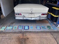

Some other misc stuff from the past few months: we did a cyanotype workshop here (cyanotypes are a sunlight-based photographic process that you can use to make art) – here’s the artist: https://www.instagram.com/_sporeplay
