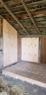

Wow... a busy couple of days! The weather has been absolutely perfect...
Drives, my misses is having a blast with the ducks. I think I mentioned, they're staying in an extra large storage tote in our guest bathroom... but, that's a pretty boring existence. All they can see is the black walls of the tote. So, we've had them out on the bathroom floor. Very funny! Those little guys can really run! I hadn't yet recycled the large box that our Costco shelving came in (2' x 6') so I brought the bottom half of that in... we cut it down a bit (now it's only about 4' long) and it makes a great duck playground. And, they can see over the sides. My misses brought in a metal baking pan that we no longer use and put about an inch of water in it and put that into the cardboard playground. OMG!!! You want to talk about splashing and cuttin' up... it was hilarious! Too much fun!
In other news, I've made good progress on the duck house project. In my last post, I think I was finishing up the OSB for the floor. I started laying it from the right side... against the wall I had previously built... so things were relatively square. As I moved toward the other wall... not so much. I had to scribe each sheet to the back wall. The first one wasn't too bad but they got progressively worse.
In pic #2, you can see how far out of square this part of the building is... I had to cut a wedge of insulation and stuff it in the gap.
But, as you can see in pic #3, I had a bit of scribing to do to get the floor covered. Definitely not rocket science but, it does take time!
So, in pic #4, the floor has been scribed and screwed down20200321_185121.jpeg20200320_092910.jpg20200320_105557.jpg20200320_112942.jpg

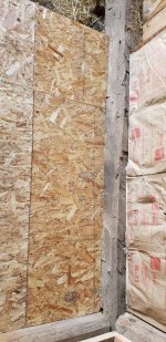

Once the floor was down, it was time to start covering the walls.
A hundred or so years ago, when I was working in the steel fab shop, someone had taken some 2" wide strips of aluminum and welded them together to form a 3' - 4' - 5' triangle that we used whenever we needed to square something large. Since none of the original walls in this building are plumb, level, or square, I was trying to figure out how I would be able to measure and mark the plywood for my walls. Then, it occurred to me that I had a couple of (almost triangular) plywood drops left from the closet I built a couple of years ago. The perfect "square". I just set the plywood into a corner and lined up the vertical edge where it needed to be and was then able to see how far off the bottom edge was... allowing me to mark that on the plywood. The back wall (that the plywood "square" is leaning against) isn't anywhere near level but, was actually pretty close to square... required just a sliver to be trimmed off. The wall on the left side was a whole 'nother story... but I was able to get a pretty good fit.
After I got the plywood on the left side wall, I finished up the insulation on the back wall. I'm not sure what they've done to fiberglass insulation. Handling it... pretty much even being near it... made me itch like crazy and would generally send me into a coughing fit that would last an hour. This new stuff... I think they call it Eco Touch... is amazing! No itch... no cough... I'm impressed!
...and, the insulation was followed by a sheet of ply. I'll scribe the strips in after I get the main part of the work done. The area I'm trying to work in is less than ideal and, I'm using our feed box for a work bench. I've had that ******* for a few days now... and my misses isn't exactly happy about that... lol So, the faster I can get the majority of my materials used up, the happier we'll ALL be!20200320_160535.jpg20200320_170306.jpg20200320_172505.jpg

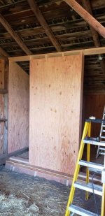

Once I got the ply on the left side wall, I was able to start framing the dividing wall. I started with some careful (as much as possible) layout, then screwed a top plate to the underside of the pole "rafters". The poles ended up being fairly similar in size and, amazingly, the roof (at least in the area I'm working on) is nearly level! I followed with a bottom plate and then measured and cut each stud, "toe" screwing them into place. Once I had four of them standing, I couldn't wait to get a sheet of ply installed. This sheet required NO trimming!!
Although it was getting pretty dark, I managed to get the last two studs cut and screwed into place. When I first got my Milwaukee drill and driver, I saw the led work lights on them and thought they were some sort of joke. But, I cant tell ya how many times they've come in really handy... tonight being one.
And, that's where I left it for the evening. Ready to sheet the last part of the wall... and get a bit of framing in above the door way. Will need to cut in some vents and have a bit of "detail work" to get the dividing wall to somewhat connect to the underside of the roof. Then, I still need to frame, insulate and sheet the last section (on the right) of the back wall. Probably won't get nearly all that done tomorrow... we have an invite over to some friends house for an early dinner... but, plan to get on it fairly early in the morning so, something will get done!20200321_170840.jpg20200321_170852.jpg20200321_172226.jpg20200321_202016.jpg

4by: you are doing a great job making a great home for your ducks. also nice work on making their play area bigger and maybe easier on your clean up of their #2's.
for a minute I thought you were covering up a window in your duck's room, but then saw that it was just framing. had you considered putting in a window or maybe it's easier to heat a room that doesn't have one?

I am going to put a couple of vents into the dividing wall... all poultry shelters need lots of ventilation. But, I will build a couple of insulated panels that will allow me to close them off when/if needed.

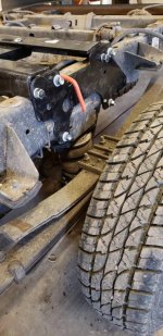

Today, my neighbor called and asked if I could give him a hand installing a goose neck hitch in his new (to him) truck. So, we went down to the farm shop of yet another neighbor and got started... at about 9 this morning. In pic #2, he's trying to loosen the bolts that secure the bed... his rattle wrench wouldn't touch them. I rounded up a 3/4" drive socket/breaker bar and we tried that. Still nothing. I found a length of 1 1/2" pipe... literally 8' long and we were able to break the bolts loose. All right were that tight. I was sure I would twist the heads off the bolts with that much torque but, they held!
Pic 3, the shop has a huge gantry crane that we used to lift the truck bed.20200328_082953.jpeg20200328_100122.jpg20200328_110153.jpg

I previously installed the B & W turnover hitch on my Ford truck so I was basically familiar with the concept but, this was a Draw Tite hitch on a Dodge so, major differences. But, we did manage to figure things out.
While we had the bed off, we also installed a set of Air Lift load levelers. He had acquired the air bags and (we figured out) the correct mounting hardware for the install but, no installation manual. And... we had no internet connection (one of the pleasures of living in the boonies). So, after a bit of head scratching, we actually figured out the bracketry and completed the install.
We got the bed back on and everything buttoned up in right about eight hours. But, I think we fought with breaking loose the bed bolts for pretty much the first hour. All in all, a pretty good day's work. He will go back tomorrow and clean up/put away tools.
It's awesome to have good neighbors!20200328_114115.jpg20200328_130723.jpg20200328_151848.jpg20200328_164812.jpg

The squared off "U" bolts in the last pic (above) are for the safety chains. We got those installed as well... no pic... duhhh...
Several people and the hitch install instructions and, several You Tube experts (for the air bags) say it's possible to do all this work without removing the bed. I can't even begin to imagine how difficult this job would have been trying to do everything from under the truck. The hitch instructions mention removing the exhaust pipe and muffler (if not removing the bed)... even if that stuff were gone, it would still be extremely difficult. So, if anyone is considering installing one of these hitches, in my experience (including on my own truck) it's FAR easier to pull the bed first!

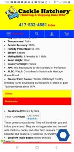

So, I probably mis-spoke there... it's been a while since I've looked at pics of Toulouse. They "somewhat" resemble Canadas. Interestingly enough, I was just doing a search and ran across several people that actually sell Canadas. Apparently, they're pretty tame and will stay around your place. I'd have thought they would disappear come fall.
Anyways, Toulouse are fairly well known for being docile and good around farms. One thing I read that does concern me... within 3 weeks they're a foot tall... gulp! I'm not sure we're ready for that! lol
The past few weeks, we've had a pair of Canadas and a pair of Mallards on our pond. We've been feeding them. Couple years back, a pair of Mallards stayed on the pond for much of the summer... raised 5 wee ones. Pretty cool. Hated to see them go.
Anyways, we'd best do a bit more thinking before the next bird order!
...DScreenshot_20200331-013759_Chrome.jpgScreenshot_20200331-014318_Chrome.jpgScreenshot_20200331-014011_Chrome.jpeg

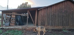

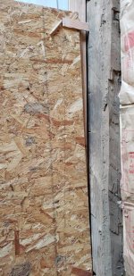

Pics:
#1 is one of the brief snow showers we had today... off our back deck. It was actually snowing pretty hard but the camera didn't pick it up too well...
#2 is the fenced area of the dog kennel... currently firewood storage and about to become an "outdoor" area for the ducks
#3 is the opening where the outer ramp will hinge. It's not going to be quite as steep as I was thinking but the non-skid will help anyways!
