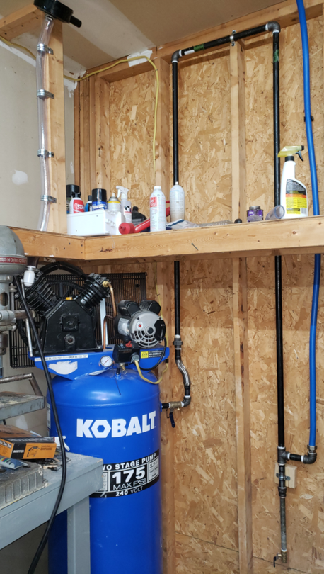

PROGRESS!!

Me too! (On hold, though, while I run electric in garage attic and then blow in insulation.)
I also plan to straighten out the blue 3/4" air lines.
I ran 1.25" ID vinyl tubing from the inlet port on the compressor up to near the ceiling and used vibration dampeners at the feet to reduce compressor noise, too.

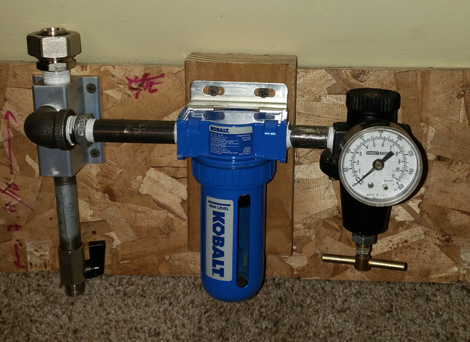

Not sure if you are serious or not.......:headscrat
In case you are......
Valve before union so you can turn the air off and when you break the union open and you aren't having to refill the entire air-line up again.
The valve in the top right of my photo is before the entire system. So I just have the regulator and filter, with the flex tube on the un-valved compressor side.
Is there a strong reason to leave the filter/regulator in the pressure loop if the compressor is disconnected?
As a side note, if I ever have to disconnect the compressor, I am doing something major anyways. I do not intend to keep the system under pressure all of the time since it is just a hobbyist shop.
Say your filter or regulator has a blowout, wouldn't it make sense to shut the air off between the tank and the filter/reg? If not, you will have to wait for the tank to drain down which could cause more damage to anything around the blowout. By putting a valve before the union it will allow you to shut off immediately.
I realize you say you won't ever, but you never know. The proper spot for the ball valve is between the hydraulic hose and the union.

So I have finally acquired all of the bits to build up my distribution system. But I am really struggling to cut the threads in the black iron pipe. Seems like no matter what I do, some of the threads shear off during cutting. Even if I go 1/2 a turn at a time and break the chips.

What is the valve in the pic? It should be placed on the hard line ahead of the hose,,, to shut and disconnect all the equipment after. A hyd swivel could be used, not a big deal either way but the valve is useless/in the wrong spot.
Note where its at here, hard line on the manifold or at the tank on the comp.
Also,,, the worry about the valve freezing in this isn't a concern. If there is freezing water in the sump leading up to it then there is. This is why they come from the factory the way they do, some water freezing in the bottom of the tank isn't a concern. It can be drained when it thaws. Some even had a drop tube in addition to the petcock for this.
I have already fixed the valve location...just need to update pictures. :thumbup:

So, I got some hydraulic lines made today. Only place I know of nearby is the Napa Auto, I got a 3/4" NPT (straight ends, one swivel) by 12" and one 1/2" (straight ends, one swivel) by 18" and I was a little blown away by the cost. Total for both: $100.73!!
Does that seem unreasonable to anyone?
