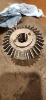

Pics of broken parts. He says they are aluminum, I find that hard to believe.

Hard to believe those gears are aluminum. if factory gears aren't available, Boston Gear my well have something you can use, or modify slightly to use. They had the gear I needed for the back gear in a Canedy Otto camel back drill I had.

I doubt your parts are interchangeable. And you need the gears because the head on those radial drills is so heavy.

-I'd want it because of the T-slots in the table, the ram, and capability of positioning the spindle anywhere you want. It's a heavy model but that also means it's stable and won't vibrate/dance like a lesser DP will. I'd find it hard to believe the bevel gear is aluminum too, a magnet will decide that. Even if a spare OEM gear cannot be located it's a fairly simple matter of getting a matching gear/rack set. If you have the space for it and the price is right I'd grab it. I've used several of that model in machine shops and preferred it. Check for bearing noise too. Good luck.

I'd guess Zamak, which a magnet may not stick to either. Zamak was the trade name for what most refer to as pot metal
-Thanks for the post, I'm well familiar with variations of the material that we (toolmakers) always called zinc-diecast (more describing the process). It's a good material for carb bodies (holds detail) and such but it's horrible for anything structural or requiring good wear resistance (like a gear). I've never been able to weld/braze the stuff and sometimes it just crumbles when trying to drill/tap it for repair. Probably that was one of the cheaper variations of the material and lends to why it's often called "pot metal". Hope things are well for you and yours.

Being they were originally made by Walker/Turner, I doubt they're Aluminum, but yes, I will have a magnet with me. I believe the bevel gears are only to raise/lower the head, so I may bring it home and figure something else to make it go up/down. I have already been looking at "other" bevel gears to swap in.

That gear is very fixable.
you see where the gear tooth was. Drill a series of holes and drive hard pins in. Then you braze up material to build up the tooth. Then you file the tooth to shape.
many machine gears have been fixed this was in the last 100 years

I have an early Walker Turner version of that saw and can assure you there is no aluminum anywhere in mine. I can't swear to the newer Delta/Rockwell version but I seriously doubt that aluminum or Zamak was used in any gear. As CR suggested, check with Boston Gear for a replacement bevel gear. A gap of 4 missing teeth will be a pain in the **** to deal with.

I replaced those two gears in nearly the same radial drill press. Mine were broken the same way. I was able to find gears of the same size, & machined the bores to match the existing. My best guess is the originals were made from Zamak.

SWEET! looks like a 36115300 and a 36115200?
Got a website or phone number they came from?
