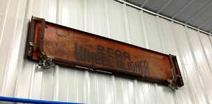

There are options (there are a lot of different trim pieces available), but I used J-channel at the top and bottom of my walls, as well as around the edge of the ceiling. It made for nice finished corners. Example:
