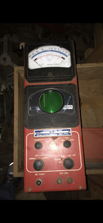

Wow! Never seen such a tester before.
Great thing, perfekt condition.
This is a wonderful example for an unit, manufactured prior they started with that code in the serial numbers.
The round gauge indicates, it being older than the sixties testers with the rectangle gauges, to be seen in that 1961 cataloge. Red colour indicates it was manufactured later than the 1940s.
Early 1950s would be my guess.
That 1961 cataloge shows a Model SX-111 Stratotach, combining stroboscope and indicating tachometer as a boxed Instrument. But that ist clearly a later unit.
