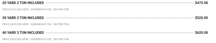

Boogerman
Jan 28, 2021
834
aspen cove hill
Assuming you don't need to get permits and do it to anyone's standards .... Make sure there's no gas, electricity, water, or sewage connected (and if there is, disconnect all that stuff first),... then get a decent sized skid steer with a grapple and go at it! Call in a rolling bin/dumpster - load it up, and call it a day. Total cost for the rental skid steer, diesel, and the dumpster will likely be under $1200 total.

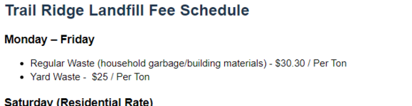

Your costs are about 30 years out of date, or things are a lot cheaper in Canada.
His tipping fee costs at the landfill are $30.30 per ton:
Dumpster rental is $620, and only includes 3 ton; overage is charged at $65 per ton.
For a project of this size, if space is available, better to demo, pile, and then hire a truck to haul loads instead of a rolloff.
Loaders rent for about $550 per day, and probably 3 days total use on this job, depending on the truck schedule.
Tonnage on a house demo like this is typically about 50 pounds per square foot of house, maybe a bit lighter since it has minimal foundation.
I've estimated and done work like this for nearly 50 years. It's not a $15,000 job if you DIY; but it's also not a $1200 job.
In my area, I'd take this on for about $10K, and make extremely good money per day doing it. And, I'd have to rent the loader and contract the truck.
Yikes! The costs in your area are STEEEEEP!
Rental of a skid steer of the same capacity is $275 CAD/day ($200 USD) or $900/week ($662 USD) in my neck of the woods. Of course, you'd need to pick up the machine with your own float trailer... or pay $90 CAD delivery fee. OP lives 3 blocks away so he could just drive it down the road.
20 yard Dumpsters in the area rent out for $140 CAD/week ($103 USD) which includes pick up, drop off, and 1 tonne tipping. Additional tonnage is $110 CAD ($80 USD)/tonne.
I'm not sure about the 50 lb/sq. ft measurement but If we use it in the calculation (50 lb x 1153 sq/ft) = 57,650 lb (26 tonnes).
All told its $3165 CAD ($2329 USD). The biggest cost factor is the tipping fees. If you can sell or burn the lumber,.. and burry the brick,.. you can easily cut that weight in half.
