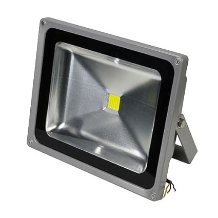

I use 6 of these in my 24 x48 shop

I've got some like Pete posted for my flag pole. Mine is a 10 watt and it's amazingly bright. $20 from amazon light is by ledwholesalers.

Pete, What height do you have the LED's in your shop? How far apart did you place them? Just completed my 45 x 45 x 16 and now I need to install lights.

my lights are 12 feet from the floor, on the long walls, first one at 8 feet,second at 24 (middle ) and the 3rd is 8feet from back wall. I had the halogens in the exact same locations. I have the lights angled down approx. 45 degrees. I have no overhead lights, the light from each side is enough for me, but the shop is only 24 wide. I'll try to get my daughter to take a pic or 2 or 3 and post in a day or so.

Which output wattage did you go with?

50 watt. replaced 300 watt halogen of a similar looking style housing.

Pete, Do you think these would work as overhead (placed between 16 - 20 feet high)? Thanks.
I think they would, BUT, how many ? I feel the "beam" doesn't "spread" quite as wide as say, the halogen I had previously. your talking 40 x 45 ? I'd go with 12 of the 50 watt 3 on the 40 at say 8,12,12 and 8 and then maybe 10,12,12,10 ? if you follow my "grid" ? 9 would probably work, but I like lots of light !! got a buddy that put some "craiglist" used some kind of halide or mercury I don't know what lights up, even when they are on it's like a cave !!

Building is 45x45x16. Has two overhead doors on one wall and three 36x36 windows on opposite wall. I was thinking 9 lights (three rows of three), with one from each side around 10' from side and one in middle @ 22. I'll also probably have some task lighting by the bench and a portable light on stand.
Looks like it might get pricey but T8's will also be expensive. :headscrat
