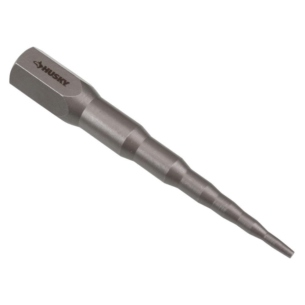

Yes, it might require a little persuasion to get it round enough to accept the pipe. The easiest way to coax it would be to use a swaging die on it again. This might be too long, but you get the idea:
https://www.homedepot.com/p/Husky-Professional-6-in-1-Swaging-Tool-80-538-111/304341669
My own set of swaging dies only has one step per piece, so it wouldn't risk poking through something inside like that Husky. Here's an example:
https://www.amazon.com/dp/B00QT0O3OE/?tag=atomicindus08-20

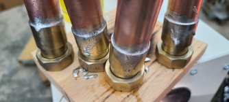

I had to sweat 4 couplers where each pair connect to 2 filters. They were vertical connectors and we way easier.
I assumed the rag recommendations were a dry rag. But these ******* were too hot to handle and my dry rag attempts were futile..lol.
Lol at these good solder joints.. they are ugly though haha

from the look of how those solder solidify on those joints , I think you waited too long to wipe. Do it immediately right after you shut off the torch... that is usually what I do.
I like moist towels, just a quick wipe and not holding it and shacking it like you are having fun with it.

Gotta be quick with the rag. Both get it while the solder is still molten, and move quickly. I'll wad it up and use a brushing action.
I'm not so happy with the bubbles in the second one from the left.

That's what all the pros do. It gets rid of the drip. But at this point I wouldn't heat it up again. It looks fine to me.
LOL. "Pros" don't wipe at all. They know how to sweat without dripping.
Seriously, though, HVAC guys never wipe, drips or not. Wiping's a "plumber" thing...:bounce:
