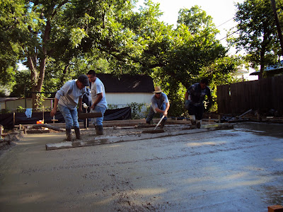

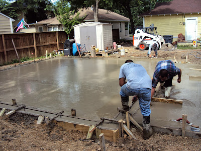

The foundation started with excavation of 24” of North Texas black clay, and replaced with select fill “cushion sand”. In our part of Dallas, one doesn’t have to dig more than a couple of feet to find bedrock. While the beams were being cut, the trencher was bucking limestone bedrock.
Beams are 12” wide and 36” deep, with spacing at 8’ on each axis. #6 steel for the beams, and #4 for the 5.5” thick slab. The green overspray is termite pre-treatment for the soil.
Concrete was a 3ksi pump mix.
Concrete contractor had a top-notch crew, and was very hands on – not a touch-and-go type that’s not present for form surveys and setback inspections. We kept a lawn sprinkler on the slab for 3 days as it cured.

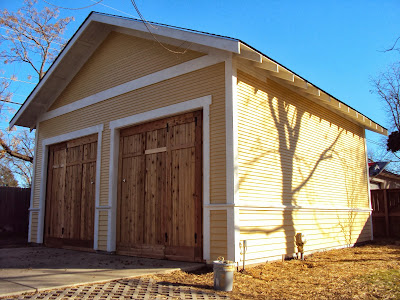

I didn’t want to give up any vertical space inside the garage. My truck is about 8.5’ tall, and I want to be able to use a lift for a coming hot rod project. Carriage doors would seem like a natural solution, except the turn into the garage is somewhat tight and clearing an open carriage-style door would be tough. Plus, those kinds of doors are expensive.
My solution was to build my own carriage doors that folded over against the side of the garage using three hinges per side. The frames are 2” square steel, and skinned in lap and groove cedar. I’m not quite done with them, yet.
This is where we are right now – primer is done, and paint is well underway. The door trim is coming to a close, and after setting up some bar-locks and getting stain on the doors, we’ll be ready to close out our permit. Next steps involve getting everything inside organized so I can unload the storage unit I rent, and start on wiring and lighting the space. It’s been such a great experience, and we’ve had so much fun that I might be a little sad to finish. But, as I think about it further, I bet this project will be like most of my other projects – I never can leave them alone.

Here are some more details on the doors.
The steel frame has three sections; all hinged using a pair of lift-off style ball hinges. Several 2x4s are integrated into the frame, and provide the mounting surface for the wood cladding. The wood cladding is cedar over a plywood base – lap and groove for the body and 1x for the trim details. Limiting straps (Strapworks.com) were installed to prevent the door from opening too wide and crushing itself. The sections tie together using DE-STA-CO latch clamps from Grainger.
The purpose behind all this: maintain 10’ of vertical space in the garage so a lift is effective on the already 8’ tall suburban.
This is the final door trim pattern. Stain (dark walnut), dead bolts, and a kustom door pull are next.

Body paint is complete, and we're on to trim. The doors are built and ready for stain. Sherwin Williams has a sale going, and I think we'll probably use the same dark walnut as we did on our house's front door.
I started with the steel frame in late November, and that took a few weekends to get both of them done. The layers of plywood and cedar took most of January since there are so many details to chisel and cope around the hinges and bolts at the edges. I've had my fill of trim work for a while.
I dug up my original design for the doors, and I made several bracing changes to save steel and weight. There's about 350 lbs in steel per door and another 100 lbs in pine and cedar, though you wouldn't know it since those ball hinges are so smooth once they are pumped full of grease.
I'm about to start fabbing the dead bolts for the doors. I figure 3/4" bar stock concealed within tubing and padlocked by Mul-T-Lock's Hockey Puck is a fairly secure locking method. I'll post more pictures of that progress.

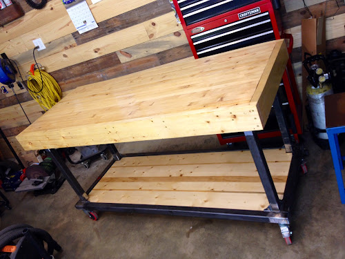

I needed a workbench. What I had was extra steel tubing, pine trim and lumber. Here's what I came up with:
I'm a tall guy, so working height is 40" - right at my belt buckle. The 2x4 top is glued and screwed and planed about 1/4" so it looks like a butcher block, while the trim board floor rests on a steel ladder frame and easily lifts out. The combined surfaces soaked up nearly 3 quarts of Teak oil. It's heavy, but rolls easily.
Turns out it's also the perfect bar height, so it's handy for hosting friends in the shop.
