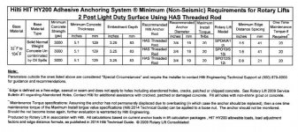

Curious on the spacing of anchors on my atlas platinum 10k 2 post lift. I'm using the supplied anchors, unknown brand.
I've read on multiple anchor sites that the general rule of thumb for anchor spacing is a minimum of 10 times the diameter. That equals 7.5 inches for these 3/4" wedge anchors.
Guessing that rule is too ensure enough concrete strength after being drilled and stresses by the anchors.
I'm assuming it was designed properly and everything will be fine but anyone know why the rules don't apply here?
On the outside of my posts, the centers of the 3 holes are each 3.5" from each other. See attachment.

This info makes me feel a bit more confident with close spacing. I don't have Simpson anchors but this doc gives the impression that close spacing is an option and shows the load adjustment tables.
It looks like perhaps the load rating for my application (.75 diameter, 3.25 inch embedment and 3.5 inch spacing) would put me around 75% of the max load.....if I had their anchors.
Would spacing be centers of holes or from edge to edge?
Page 8 - http://embed.widencdn.net/pdf/plus/ssttoolbox/jbt2lcsbeh/C-A-2018-Wedge-All-designinfo.pdf
You really need to contact the manufacturer of the specific type of anchor your are using... and if they recommend against the layout, then contact your lift manufacturer.

Epoxy anchors require very little torque on the hex nuts, 20 ft-lbs for 3/4" anchors.
Mechanical anchors require a lot of torque on the hex nuts, 180 ft-lbs for 3/4" anchors.
Once again... (for everybody except Finn) that means an increased load on the concrete if you are using mechanical anchors.
