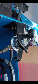

I am getting ready to do some battery cable work. I am looking at the 16 ton, long handle, blue colored import on Ebay. You can get the whole kit with 13 dies for $50~. The dies will hex crimp from 8 awg up to 4/0awg(?)
This will have the giddy-up to do more than you need. I looked at custom cable builders and the brag about using 10 ton units.
Be careful what cable you use. The "welding cable" type jacket is not good in oil or petroleum environments - no matter what they say.
FWIW I'm in the crimp camp, provided it is properly done. The fact that aviation mechs use it is enough for me.
When I cleaned up my RV battery box, I used Temco shrink wrap, terminals, and the TH0012-8 crimper. If you have the need for the interchangeable dies and the extra money, the hydraulic one looks good for a buck and a half.
The lever one like I used, required putting on a solid surface like a garage floor and using both hands and body weight to compress. Other caveat is that the gauge scale on the side is more of a suggestion. Dial up what you think you need, crimp and pull test the fitting. Look for voids around the terminal that can allow corrosion to seep in.
