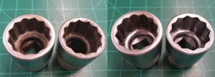

Without showing EVERY socket being cleaned, I'll just post a few Before & Afters.....

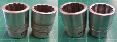

This next picture shows the different broaching of the two sockets.....
The 1944 socket (on right) shows the socket construction with a machined recess below the broached area.....and the 1956 socket (on left) shows a hot-broaching method that created a distinctive ring of displaced metal....
Snap-on made the change to hot broaching in 1947.....(sourse: Alloy Artifacts)

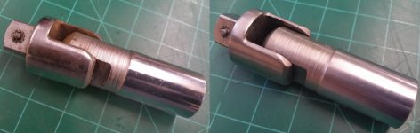

"Nut Spinner"....Before & After....

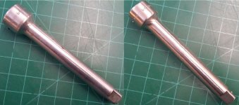

8" Extension....Before & After....
Sliding Head.....Before & After....
Sliding Bar Handle....Before & After....
Ain't it purdy?........:D

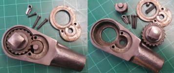

Now, on to the L-72 R Ratchet Head......Date code 1963
This piece looked the roughest (inside was in fantastic condition) with a lot of pitting.....I wasn't looking to try and fully restore it, just clean, lube, and get it looking respectable.......;)
Front & Back....Sides....Top & Bottom....
Front & Back....Sides....Top & Bottom....After a few rounds with a wire wheel...
It's time to go inside.....

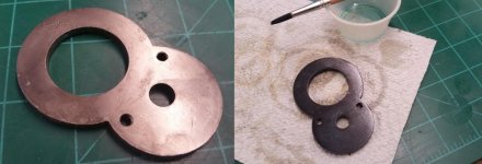

Everything is cleaned and ready for a few pieces to be blued.....
Starting with the cover....
Here's the drive gear.....
After bluing we're ready for re-assembly with the good ole Super Lube.....
And now the Before & After.....
And finally the comparison of the first pics .....Before & After.....

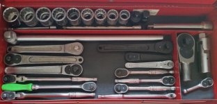

Here's a shot of all the pieces (including the adapters) in my KRA-58E box....
Also in the meantime I bought 4 Williams 3/4" sockets to add to the set (from GJ member wantacoe)
Pics from his ad.....
Of course when I got them....they got the SPA treatment....
Now, here's the shot with everybody together.....

Spent a few weekends cleaning up this old Stanley. Each time I work on one of these projects I re-insulate all the wiring. Also replace all wiring to the switch and add a ground.
(Note: I’ll add more pics later. Getting an error on Tapatalk)

Ummmmm.... yuck!
Tip. Don’t turn these things on until you inspect the internal wiring. The last three drills I took apart were very iffy.
200 grit to start on most parts. Finished with 320 grit to 400 grit before moving to the buffer.
The emblem was very worn out rubber. I decided to try a brushed look and remove it.
I’m still learning a lot from this site. After I sand with 320 or 400 I buff with black compound on a medium buff. Slowly work up the red then white compound. I may make a video on my next project.
I thought this was an interesting brand. It appears to be chrome finished so it will take some work to remove and polish.

If you sand your projects with 400 then 600 then 800 grits you will find the buffer work to be much faster and you can skip the black and red sticks
Thats how I do it. Sometimes I'll use 1200 too (Just an FYI)
I tend to get sick of sanding after awhile and prefer to move over to a machine. Do you know of any good mechanical methods of sanding at this grit level?
