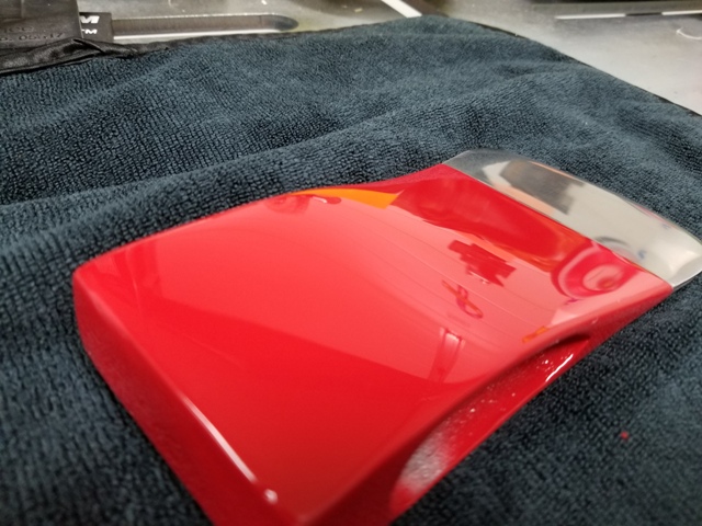

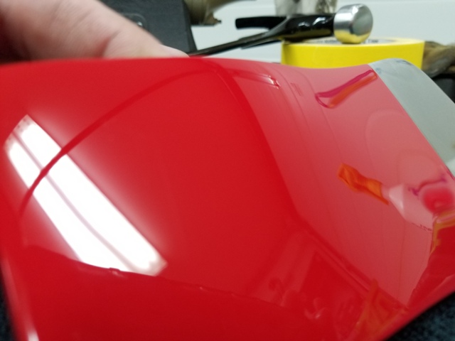

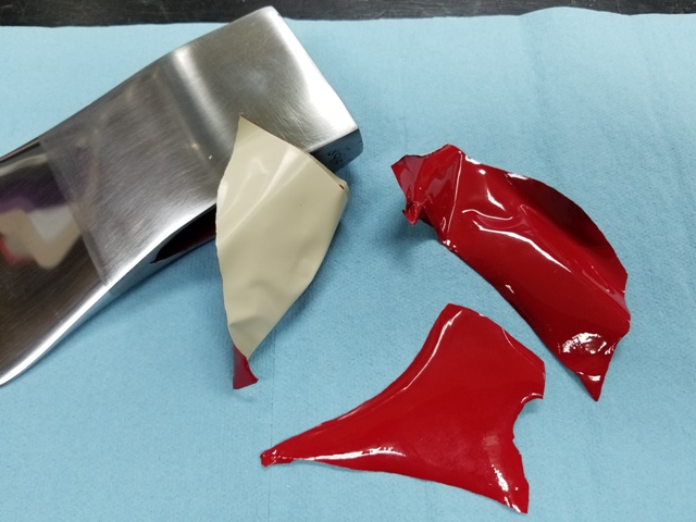

There was some trial and error involved!! The pics were from the second time I painted it...
The first time I didn't scuff up the surface enough after polishing the face, this happened, opps...

I was wondering why you polished the whole thing, only to paint. Also if it would work well.
I got a little carried away with the polishing!!
The first round didn't work so well!! I also used a 1k primer to start with, it might have been the wrong choice? Second go round I used 2K primer, and reblasted it first...
I want to clear the whole thing, but I am not sure about the clear sticking to the polished surface...

I've sprayed clear on polished areas before and some products work much better than others. there is a rattle can clear that works very well but tonite I don't remember the name of it . O'Reillys parts house carries it
I wet sanded it, then cleared the whole thing with this,
It stuck great!! I even wet sanded and polished the final clear coat... It came out like glass!!

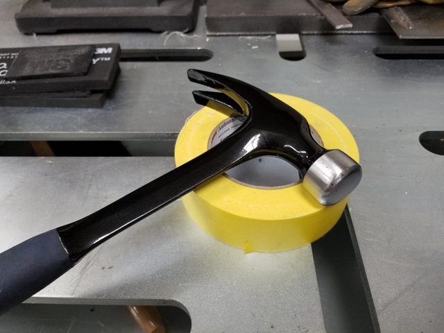

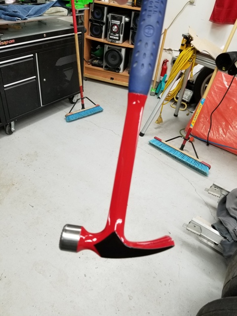

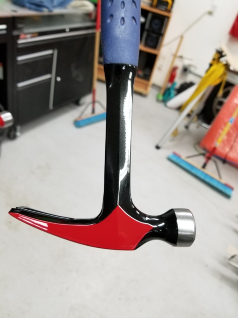

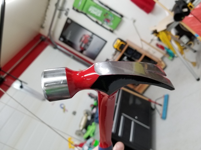

I painted one of my hammers while working on the axe head, lol
Tuxedo Black, same color as my truck...

Now that's a custom hammer. Your axe looks fantastic. The extra work was well worth it. where are you planning to hang it? somewhere that you will see it every day I'd hope!

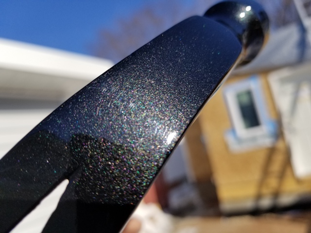

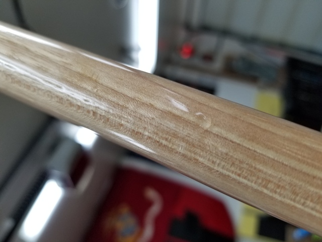

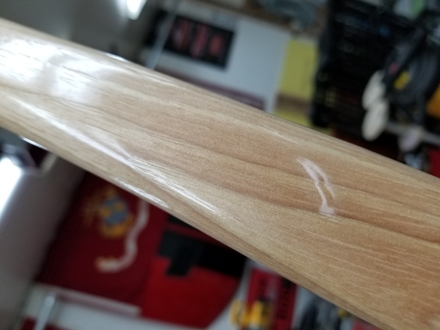

Thanks Drives, I love working on these kind of projects!! Painting the hammer was an after thought!! I had 2k clear left from the axe head, so I wanted to use it up... Threw the hammer in the blast cabinet, and I had the Tuxedo Black base coat from when I painted my trailer!! Now I have to paint the rest of my hammers too!! I want to paint my monkey wrenches green at some point too!! Lol...
I wasn't happy with the handle so I sanded and cleared it... Got a bit carried away and got some runs... It was late and dark outside!!
I will hit it with 320 and throw on a couple more lighter coats of clear...
