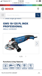

Inox grinders are made for use on Stainless Steel, hence the “Inox” label.
The top rpm speed is lower than on regular angle grinders of the same size, usually topping out at about 7,600+/-rpm, and generally including variable speed and the other electronic features usually included with variable speed.
  • Vario-Constamatic (VC)-Full wave electronics with thumbwheel for working with materials requiring customized speeds, which remain almost constant under load
  • Electronic overload protection, soft start and restart protection
Other German power tool manufacturers like Flex and Fein also make “inox” grinders.
