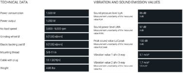

Can we get back to talking about high end, electric right angle grinders?
What do you think about the Metabo W 13-150 Quick ?
6-inch disc at 10,000 RPM. No variable speed. No electronic speed control. Simple basic grinder with no electronics.
looks nice, but aside from longevity concerns, is electronic speed control (not variable) actually bad? i like bells and whistles, lol.
the most compelling 'dumb' 5" grinder i've seen so far is the one that @scooby074 mentioned.
pretty universally praised as heavy duty and abuse resistant. old design, very battle tested, looks like all metal housing, possibly made in canada...
the most interesting (to me personally) 5" grinders that i've seen are:
  • makita 9005B -- $190, 6.6lb, 12krpm, canada. seems super bulletproof, but main downside is the weight at 6.6lb.
  • metabo WEV 15-125 Quick (600468420) -- $270, 5.5lb, 2.8–11krpm, germany. seems to have most or all of bells and whistles including variable speed with no real downsides except for the $270 price (and longevity concerns inherent to the bells and whistles)
  • metabo hpt G13VE2 -- $170, 3.75lb, 1500W, china. brushless, very lightweight.
the last two are variable speed which i think is nice for versatility, and i don't think they're gimped. i really do wonder which is the most powerful and could cut fastest with a 5" disc. i somehow suspect the brushless one could win but idk. it's the most powerful on paper...
i'm still leisurely browsing, though.

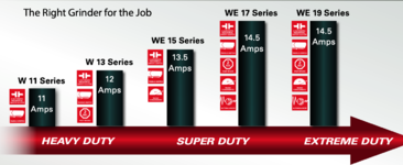

is there a model number guide somewhere for metabo's grinders?
i get some things like V is variable, P is paddle. some of the other letters elude me. like idk what precisely E means.
but what about the numbers?
ok, so e.g. 15-125, the first number is the motor size or something like that. bigger's better. but what about the second number?
and then there are models like 1500-125... where does 1500 fit into the above lineup? lol

I'm afraid if I had electronic speed control, I wouldn't know how much pressure I'm applying to the implement. I try not to put too much pressure on a grinding wheel because I'm trying to keep the metal as cool as possible. Metal doesn't grind well when it gets softened up from the heat. When I hear the RPMs drop, I let up on the pressure so that I can keep the metal cool.
I wouldn't recommend a rat tail grinder. The reason why is you have a limited area from which to hold the grinder from. With my little side switch Bosch, I'm changing my grip placement all over the place to get in the most comfortable position.
Then there's the trigger on the rat tail grinder. You have to squeeze the trigger and then press a separate button to lock it on. That's two steps every single time. With the side switch, on and lock on are all done in one step.
