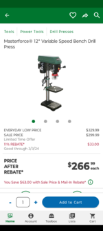

I had a craftsman one like those and it worked really well till I accidentally broke the work table. I upgraded to the Menards for variable speed. It is great.
