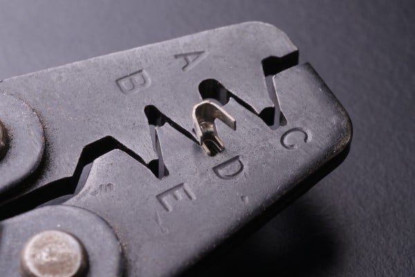

No, and I'm not a fan of open barrel crimps. With open barrel, the finished crimp barrel has a split, so it relies completely on the spring temper of the brass to maintain pressure, and that can become a problem with any sort of heat present. With a closed barrel, the perimeter of the crimp is continuous, so much of that pressure is maintained by the tensile strength of the brass.
If you're talking about insulated terminals, open barrel is complete trash. End of story.
The open seam at 12 o'clock is going to lead to issues with the above bargain basement fork terminal. Quality insulated terminals (still not as good as uninsulated) braze that seam closed. When you indent crimp an uninsulated closed barrel terminal, you put the indenter over the braze, because that's the annealed section. You don't indent crimp insulated terminals, and pressing the above open barrel from above and below just allows the barrel to open, leaving you with a terrible confined crimp (not an issue with a closed barrel).
Open barrel can work acceptably with pin connectors, when the proper calibrated crimping tool is used in an F crimp (end result shaped like a B), but it's very unforgiving, and you need to especially beware of an industry awash in counterfeit products, because it's difficult to make a closed barrel that will perform badly, but it's also very difficult to make an open barrel that will perform well, and it's damned near impossible to know whether or not critical steps were skipped in the forming of that open barrel part from a visual inspection.

This is the type of open barrel crimp I am referring to.
Essentially the same crimp that is on most all of the connector pins in these applications.
Then weather seal with raychem SCL heat shrink.
Yep. Those two grooves and the flare towards the ends is put in in the stamping to work harden the material, so that it has more backbone to hold the crimp closed when it's formed. And the end product is entirely dependent on these details, which in turn are dependent on a real quality control system. That's great if you KNOW your parts are legit, but downright scary if there's a chance they're counterfeit (I'm not throwing out accusations, just explaining my reasoning why I avoid these, largely since I'm not installing them in bulk, so I can't buy them from an ISO9000 source).
