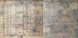

31,061
LS:
Here's a wood box Set D label zoom.
And here's what I noted back in 2017 in posts #44 and #46 (found on page 3) - now expressed in more organized form in a table so we can discuss and try to understand and resolve it even further.

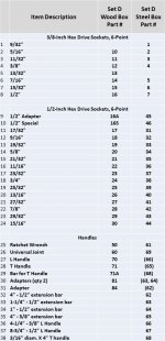

31,061
Comments:
- As I noted back in 2017, they seem to intentionally avoid duplicating part numbers, despite the fact that the wood- and steel-box sets have common pieces, going to an arbitrary system as opposed to the number of 32/nds, as you have already noted yourself. Unless, as you have alluded to, they aren't exactly the same and they wanted to distinguish them.
- Note that part No. 81 (row 30 in the table) is Qty 2. That might help identify it (description is illegible)
- Note that part numbers 8 and 9 are not used in either set (apparently because they didn't serve any purpose in the wood box 32/nds scheme, and weren't needed in the steel box scheme).
- I listed the items verbatim in table rows 32-37 and the format is OAL and then drive size
- Once we sort out which handles are common to both sets, I can update (compress) the table (e.g., row 27 and row 36 are likely the same tool), but for now I have them listed separately.
LesserSon
Feb 7, 2016
5,123
PA USA
Yes, thank you Lugz, please take a breath.
Thank you for the driving directions: posts 44 46 50 51 definitely anticipate my own exploration - you got there first.
Much easier to navigate the realm of BSPCo with a guide. “Here be Dragons” and “Terra Incognita” should be posted liberally. The doppelgängers and simulacrums are just a few of the hazards. More QuickSand than QuickWay, if you ask me.
Especially thank you for the tabular chart: exactly what I had in mind. Easy to see those sinkholes before falling into them. If I may presume to suggest some anmendments...
I think line 10 should read 16S not 16B for the wood box list (wbl). I am confident that line 25 is 50 not 68 for wbl, and line 26 60 not 69 for wbl.
Lines 30 and 31 say “adapters” and “adapter” in the wbl. Note there is “1” of every item, but “2 #84 adapters” on line 31 wbl. I speculate these three adapters are equivalent to the “extension bars” in the steel box list (sbl), maybe #81 being two 1” extensions and #84 being one 4” extension.
I hereby claim “educational purpose” for the cleaned-up screenshots.
