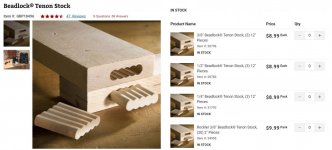

Isn't there a jig that lets you drill overlapping holes to form a mortise and lengths of matching stock that you cut up for floating tenons? I think there is also a router bit to make your own tenons. It basically does what the Festool does for WAAAAAY less money. If commercial production speed is not an issue I would look at that. Sorry, I forgot the name but I am sure somebody here knows.
Beadlock pro at Rockler. Anybody used one?

No
Personally, I don't like what I consider 'proprietary' solutions. 'tenon stock" to fit that beadlock is $9 for (12). That would get you (100) 3/8" wooden dowels.
Another thought - have you ever worked with a SOSS invisible hinges? If you have a router, WoodHaven makes an excellent jig for the #204 SOSS hinge which could also be used to make some really nice 1/2" x 2 3/8" floating tenons. Making the tenons in that size is pretty easy to do
Beadlock makes a router bit to make your own tenon stock. You start with a piece of rectangulsr stock and run the router bit down each side. You can crank out miles of tenon in the wood of your choice. My question is how well does it work? Is it easy or awkward? It looks good on paper. The pattern on the tenons gives you a little more surface area than a plain tenon. I seem to recall a strength comparison test of vaious floating couplers and the domino did not win.
I didn't know that, thanks for the info
