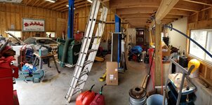

Today, I opened up the new garage doors and once again committed myself to cleaning up yet another mess of accumulated estate sale finds, half finished projects and a riding mower and leaf vac that was ready to transform into just a mower.
Here's the before picture in panorama mode from the door. A big Pexto circle cutter sits in the middle front of the lift bay, next to a stack of sale-bought tool boxes that used to live in the other garage but now have no home. Behind that is my old welding cart, next to the still unfinished Craftsman power hacksaw table. Behind those, barely visible, is a stack of leftover 12' 2x6s and several scraps of plywood that need a new home. Next, in the foreground and far corner are my forest of tall ladders (I really need to thin the herd).

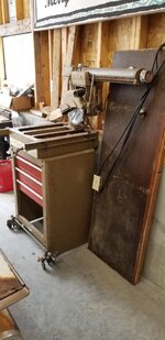

Also not visible behind the mower is my 1958 bronze-era Craftsman radial arm saw. I've decided to keep this one, as it is from the very first year of production and it has some pretty cool late 50's styling. My other bronze era RAS is visible over the roof of the white Impala. Its a '60 model year, in better shape than the '58, but I don't need two. I have a box in hand to send in its motor for the recall, but I can't yet bring myself to butcher it up. I've listed it for $120 on OfferUp and will let it run for a month. If I can't sell it for at least the recall bounty by then, I'll pat the old fella on the neck and send him in to the Great Reward.
Here's a better shot of the saw:
In the middle of the picture is my riding mower and CycloneRake leaf vac. I bought both used when my teenage resident labor left for college two years ago. The mower works fine now that I have a new battery and fresh blades in it, but the leaf vac's been a disappointment. I think maybe I expected too much of it against the output of our four mighty oak trees. Next season, I will run the rig more often, rather than waiting until all the leaves are down, snowed on, melted on and generally packed into the grass. Meanwhile, I'll collapse the vac frame, remove and store the engine and hang the trailer up on the wall opposite the garage doors.
Further to the right, more disorder is visible. The generator is sitting in the walking aisle because its parking spot at the end of the workbench is blocked by a pile of stuff that just got pitched there during winter projects. The workbench is a cluttered mess, too. Electric heaters are still out, so I'll get them blown off with compressed air and stored above on the mezzanine shelving.
